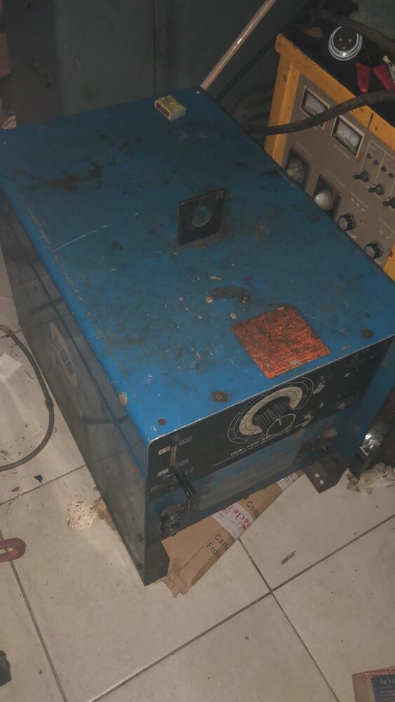

Good day, I recently bought a Dialarc 250 AC/DC (not the HF) and I have a few questions.
I looked inside, but could not see a thermostat, I am wondering if these machines usually include them, and if one in not included. Should I install one?

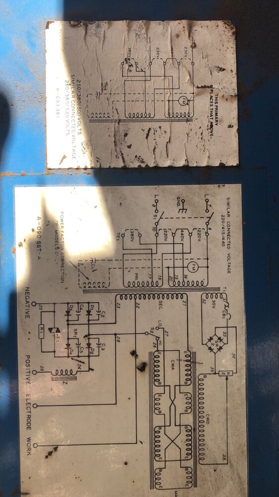

Secondly it is currently wired for three phase 380v, but it only uses lines 1 and 2. I am running it of a rotary phase converter, but that is likely quite inefficient and I would prefer to wire it for single phase. The issue is that it says it can be wired for 120v 260v and 380v 3 phase. I only have 220v single phase. Is it possible to buy a 220v to 260v transformer and wire that in and how advisable would this be?
