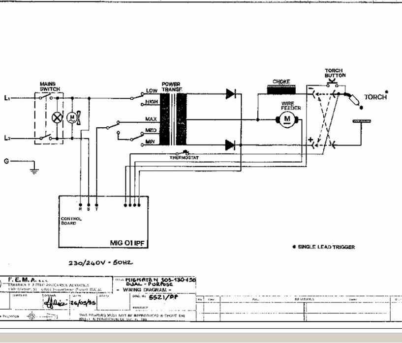

M Martin77 New Member Messages 12 Location Devon UK Dec 6, 2014 #21 I traced 12v ac from the transformer up to the rectifier, and not after it, so I just replaced the rectifier...and lo, it works! once I got my head around the layout it made more sense. Thanks for the support
