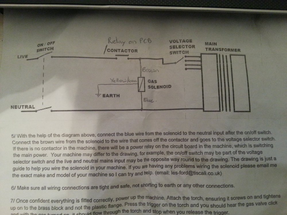

I've been experinceing problems with my welder for a while thinking it was my inexperience that was the issue until i noticed the torch was leaking air. So ordered a new gas valve fitted today and noticed it's the wrong valve and there's a hole in the outer cord which has damaged the inner gas line
So why not bite the bullet and upgrade and get a euro torch conversion kit. Before i go and make said purchase what should i be looking for or aware off? I appreciate there is some wiring to be done and not expecting this to be easy however i have a lot of patience and Friends who are good with wiring.
I have found this kit on ebay http://www.ebay.co.uk/itm/MIG-EURO-...B15-3MTR-TORCH-AND-GAS-SOLENOID-/111252507993 Which includes the solenoid.
