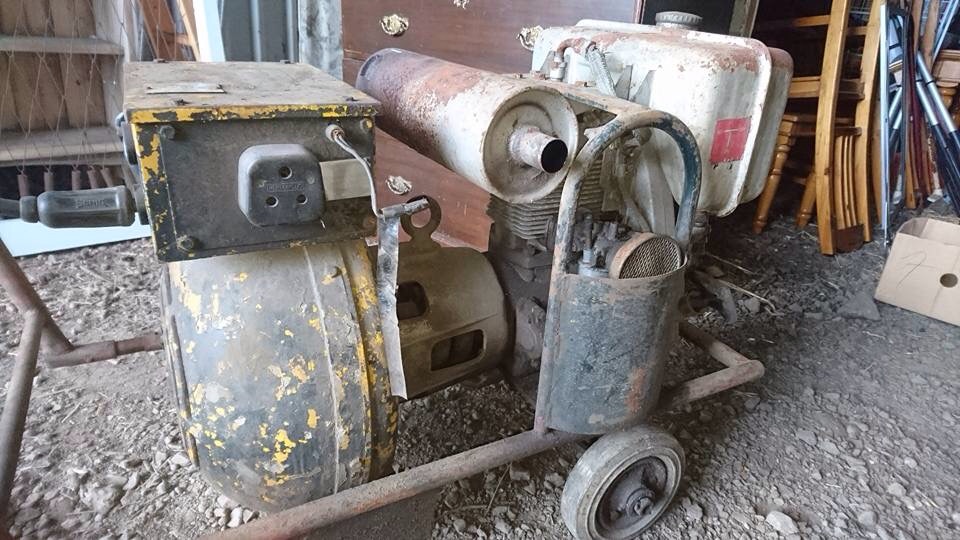

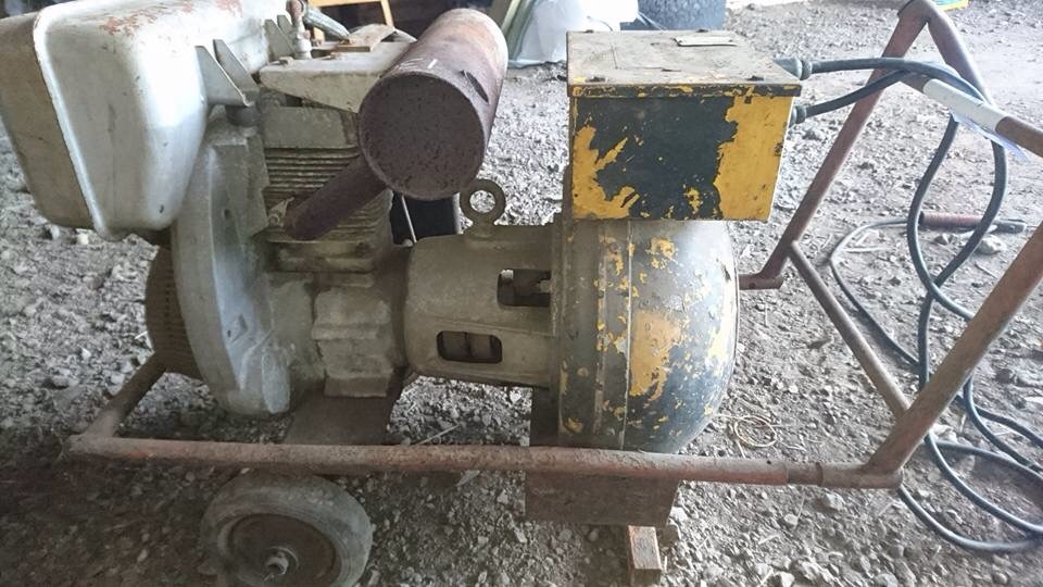

Had an impulse bid on a petrol welder not having a clue what it was and if it worked!
Turns out it works well!

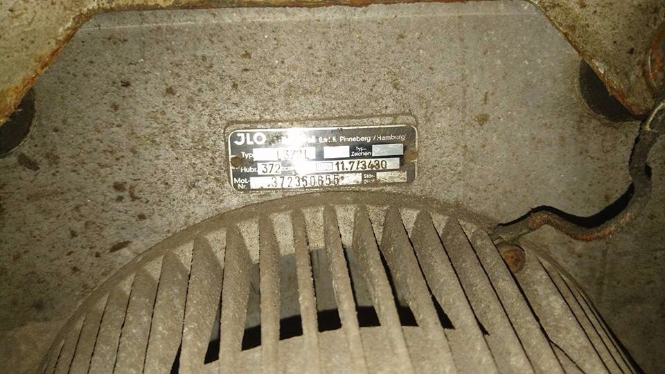

Two stroke 372cc makes a racket and a half, but it started easily , struck an arc with 6013 3.2 rod and melted its way through 3 mm plate with ease.

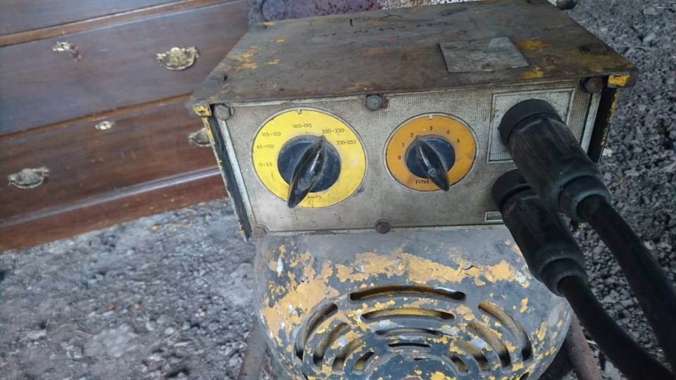

Came with long cables although the rod clamp is wooden!

What voltage can I expect from that round pin socket?

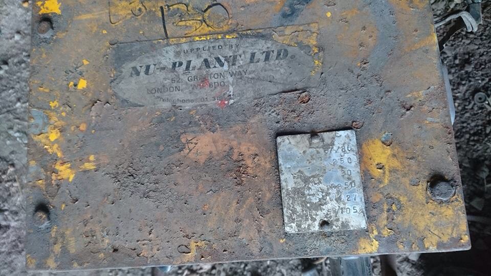

Thus one has a max output of 250amps.
		 Love mine... That aux output will be DC, probably 110v
