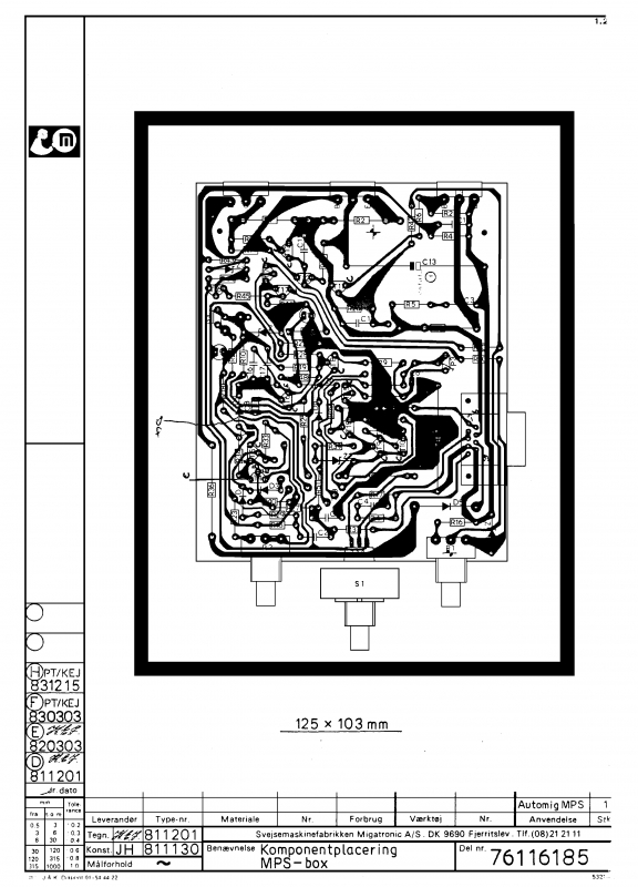

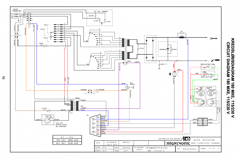

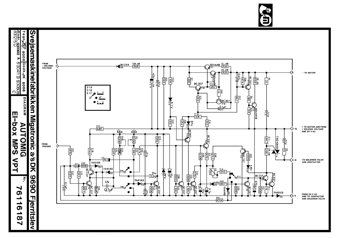

my wire feed stopped working. I can hear a click when I trigger the torch. I can get the motor to turn by pushing in the contactor for some reason the coil in the contactor is not making? I don’t have prints for this machine Looking for clues? I metered the coil and I’m getting 5 ohms. I’m seems I have 10 volts power running into either side of the coil?
I wonder if something in the control board is bad?
