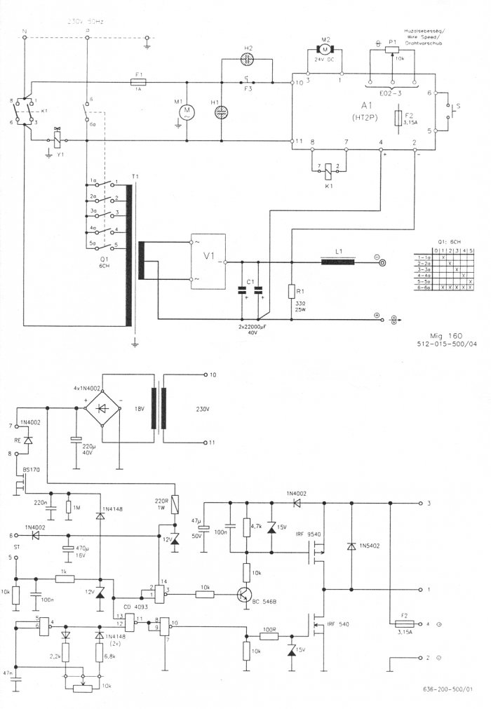

hello everyone i,am new to this forum etc, and after some help & advice please" regarding my mig welder when used on low settings for car body repairs. Would it be a good idea to replace or retro fit capacitors to make for a nicer smoother weld on low settings. The only reason i,am asking is its as clear as mud the info iv,e looked up on google so, now want to learn more if doing these sort of modifications or upgrades actually work for the better as my welder is old/aged bought secondhand from ebay last year and only gets used when and as needed etc. Also i must add" i hav,nt had the side off my mig yet to look for any capacitors and to be honest its age and how long is a capacitors life accessed and when do they require replacing etc as i do repair the odd valve radio etc and have the tools at hand or is it a case of if it works dont fix it""
KDU5SE (almost looks like a call sign?) Looking through the few schmatics I have (courtesy of other members posts) could only fine one for a Migatronic 160. Looking at that shows 2 x 22000 uf 40V caps. Not sure why you are looking to mod machine but when i had some problems with one of my welders and it's capacitor (the rivet that attaches the blade connector to the cap had become loose and intermittent connection) this fault would cause the weld to not penetrate and sit ontop of the metal even on the highest of the 6 power settings! then sometimes it would connect ok and if still on a hight setting would blow through. Ended up replacing the cap for a new one to fix.
