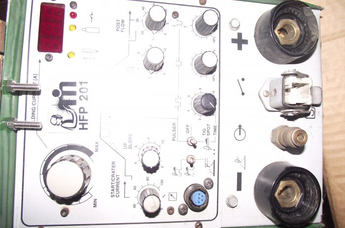

Having purchased above tig welder and attempted to figure it out and loked at historical booklets ontheir website, can anyone send me a pdfvofvthe destructions for it? I have notedcthst the hf spark is a little week too, any ideas

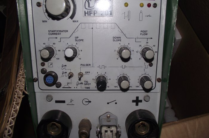

It would be better if you could post a decent close up photo of your welders control panel, pretty sure then we will be able to tell you what every thing does
first knob is pulse frequency
2nd looks like pulse on/off time,or sometimes called pulse duty
3rd looks like background current,a percentage of welding current/amps
set toggle to up for pulse on
middle pulse off
bottom is to set spot welding timer,same function as a mig spot timer.id imagine the first knob is only functional then,the same as used for pulse frequency,but sets time on for spot weld
