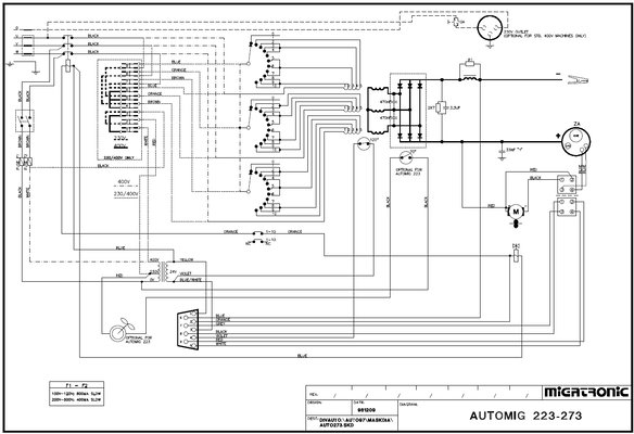

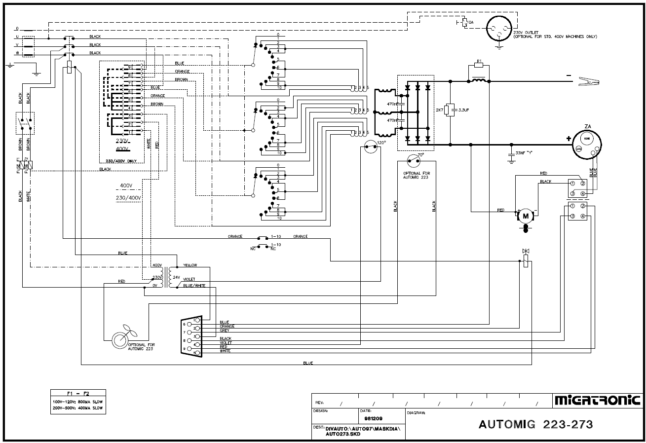

Hello fellow diy-ers,
I have an old Automig 273 where the wire feed stopped working. Here is what I have tested so far:
- Strong arc when handle is pressed.
- The wire motor it self is working when connected to 12V.
- With motor disconnected I measure correct voltage over the wires going to the motor, but with motor connected the voltage drops to zero.
As you know the plus side of the wire motor is connected directly to the welding current, and because the arc is strong, I assume that the plus side is ok. So the problem seems to be on the minus side, probably on the pcb somewhere. There are no obvious defects like swelled caps or burn-marks on it. Does anyone have a suggestion where I could start looking?
Any help would be much appreciated,
-Are
