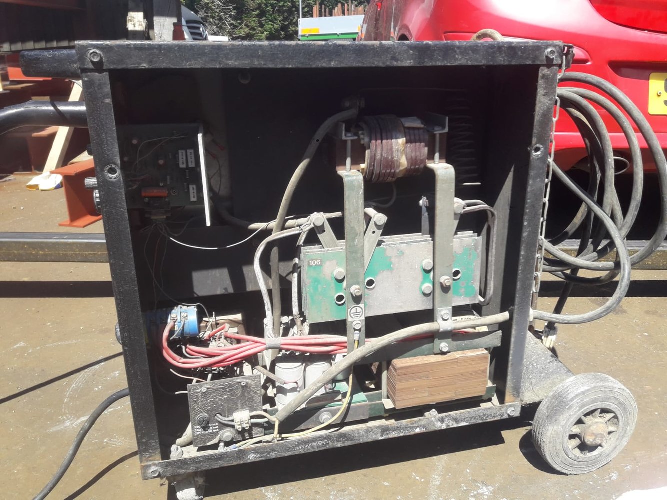

The voltage selector switch should turn to the "0" ( = Off ) position. Something may be wrong with the shaft detent mechanism that is preventing it from rotating fully. Please don't be tempted to dismantle the switch, it nearly always ends in tears.
X2
If it selects everything except 0, I'd count that as fine. I did successfully dismantle and rebuild a 12position one but it was a nightmare. Did work well afterwards though.

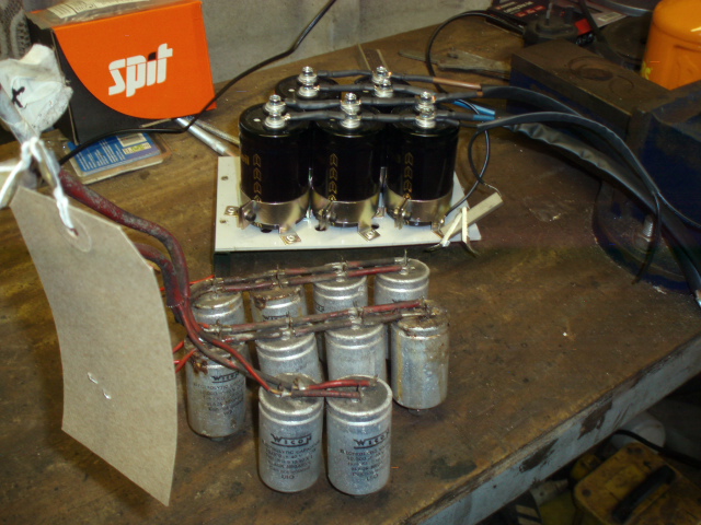

No mention of the original caps Wico/Wecon or whatever they call them.
