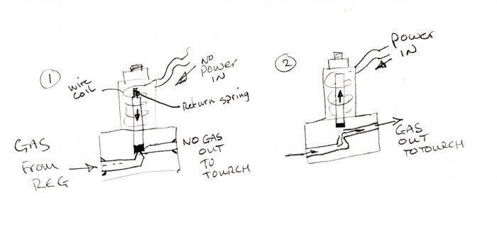

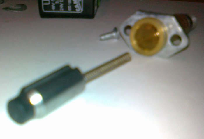

Last pic bottom left corner shows rubber tip on end of plunger. There is no macro/close up on camera phone so details from this one is 48V 50/60 Hz 3.8va 24VDC 3.1W So this one cann operate on AC 48v or DC 24V. THese are used on the kit I work on.
