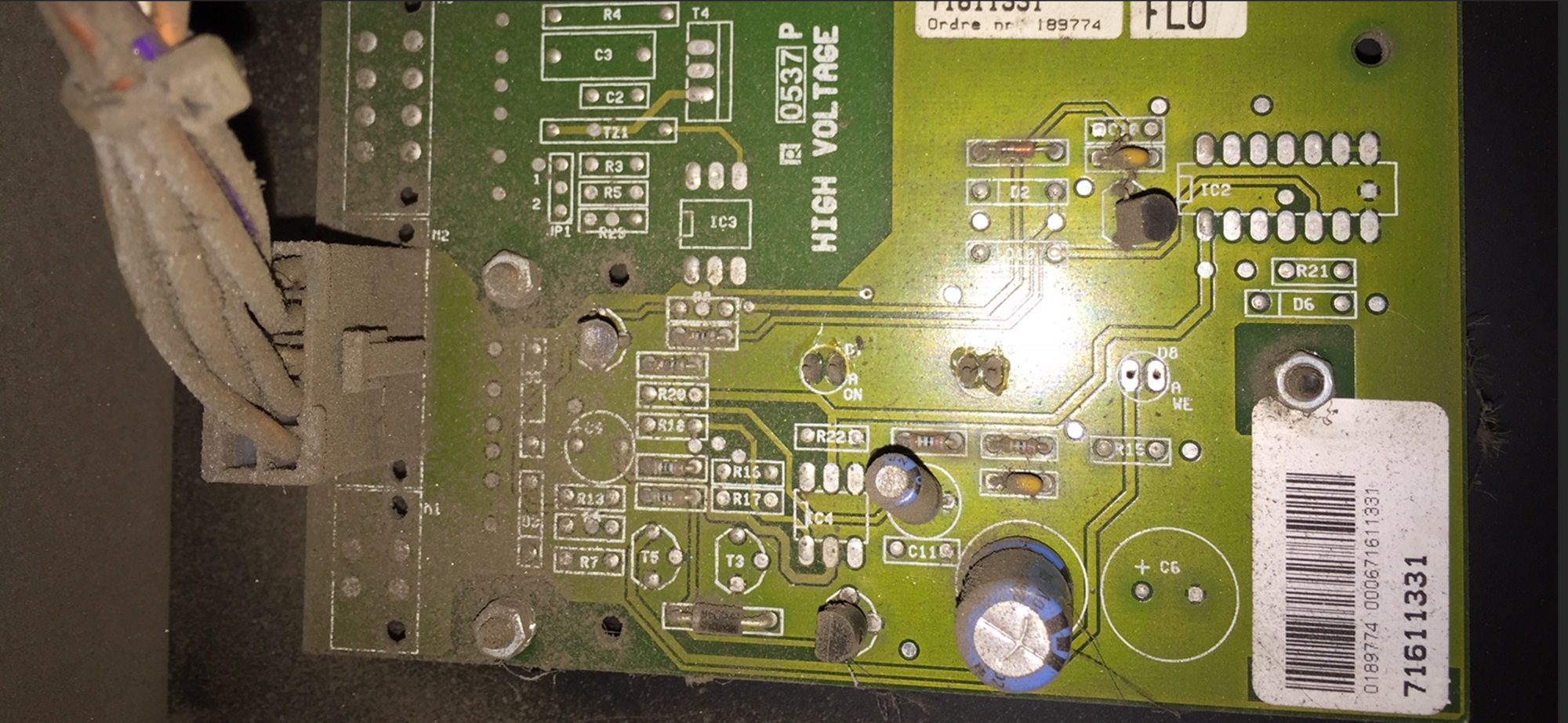

Wondering if anyone can point me in the right direction! I've Got an issue with my migatronic 305. Welder is feeding wire but no arc. Contactor is not operating but appears fine but there is no voltage present at contactor when the trigger is pulled. Will arc when manually pushing contactor in.

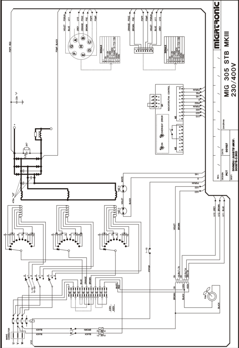

Is it the PCB board? Looking at the diagrams there is only one switch "1-10" on the orange wire feeding the contactor, what is this switch?
Transformer has output voltage on the various legs so assumes fine.
