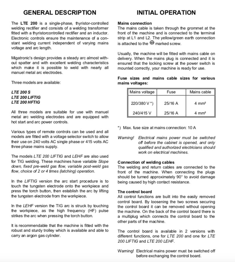

Hi, I've just picked up a Migatronic older transformer, a LTE 200. It has a switch for single or three phase and I'll only be (hopefully if it works) using the 240v single at home.
Thing is, it has the 5 pin red large plug on it as it has only been used as a 3 phase machine. My question is,
"Can I just put on a large blue 16A 3 pin plug instead? If so do I just pick 1 of the 3 phase wires from the welder as a one of the 3 lives?"
Thanks in advance.
