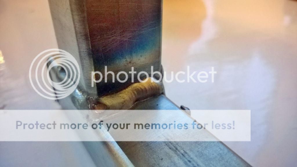

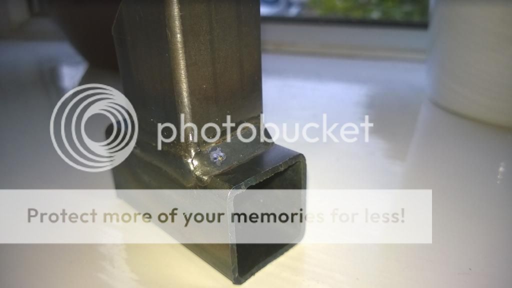

Allowed in the garage....... I'd get all moody if I don't get my fix of garage/workshop time, just like that seasonal disorder stuff.... Well that's what I tell everyoneThanks all! I will give your suggestions a whirl the next time I'm allowed in the garage, and will post some further pics once the welds
get better.
To my eye the stop/starts at the corners haven't completely joined up to form a continuous weld. That's just a the point that will see the most strain. It's better to start a weld at the middle of each side and end it at the middle of the next one. Welding around corners is an acquired art, but it makes the joint less prone to cracking up at the high stress points.
