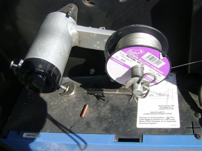

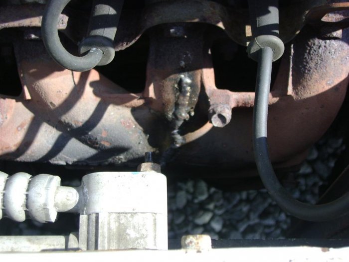

You guys know how hard it is sometime to weld an old junky exhaust manifold? I have done hundreds of them over the last 34 years most of them stick with Ni rod and some brazed. Some worked well some didn't. So move ahead 30 years i picked up some Crown Alloys .035 44-30 mig wire for cast iron. Its used with Argon and works great. This manifold on my Geo Metro had a crack and it has been hissing for 4 months or so. I drove the car around to warm it up since i wasn't planning to remove it and hit the crack with a die grinder and a stone. Then i dabbed the mig wire in the clean area and triggered it right up the crack. It took about 30 seconds and sealed the crack right up. I let the car run for a few minutes and then let it cool. So far so good. The 2# spool is 75 bucks and i wanted to try it out for a test...Bob
