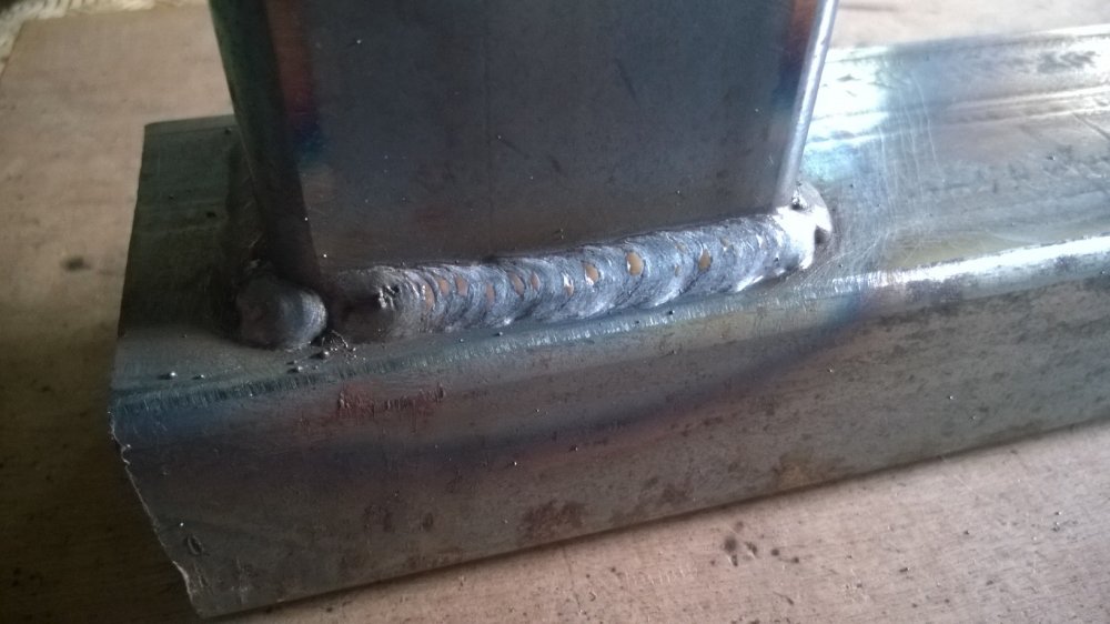

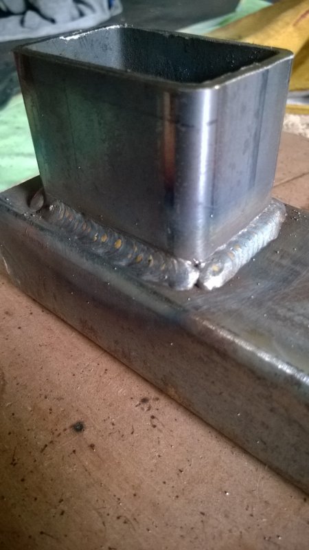

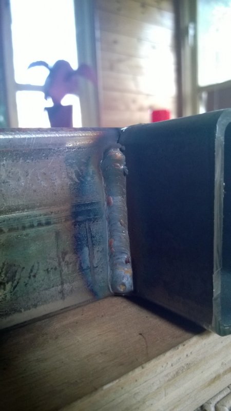

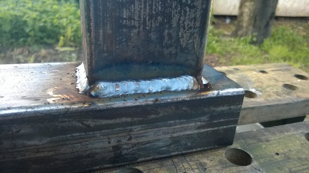

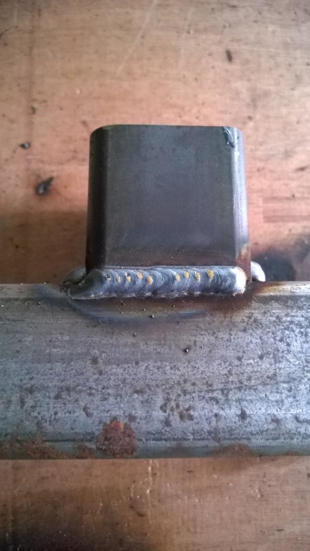

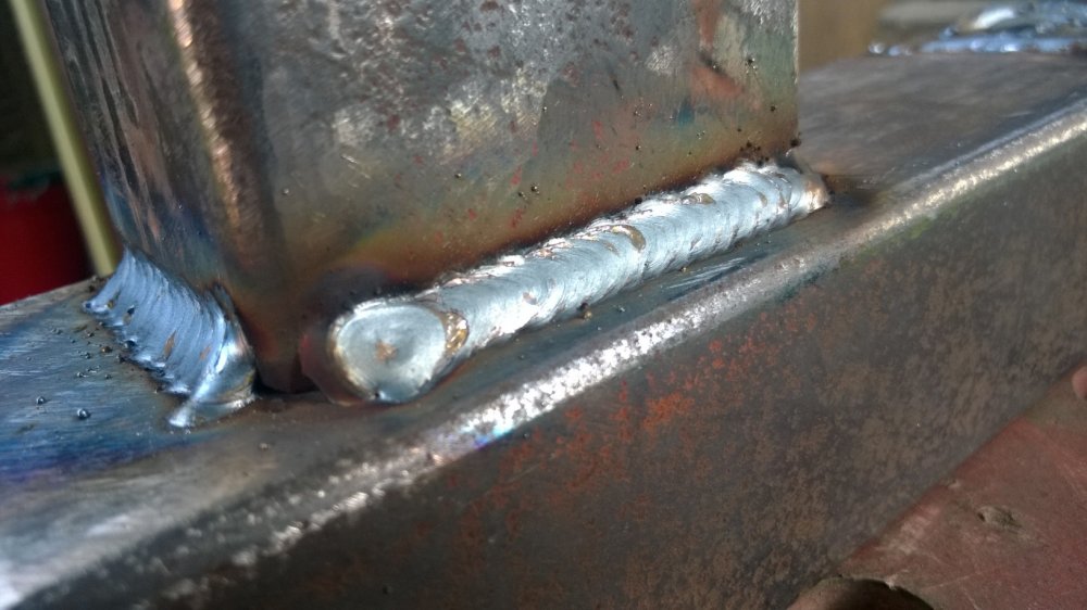

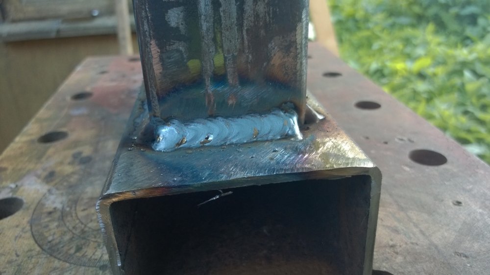

evening all...
today i thought i would take a break from the stick..and put down a few mig welds..now i set my machine up on 3mm plate..same wall thickness as the box i am welding...the plate i had set on power number 3 with 3.2 wire speed..but it did not like it on the box..so i adjusted settings to power number 4 with 2.9 wire speed..it flows nice at this setting with good penetration but has under cut..so do i drop down on ampage and up on the wire speed..or just tweek the wire speed..these are just a couple of quick beads i did this evening..but when done properly they must be strength critical.....
