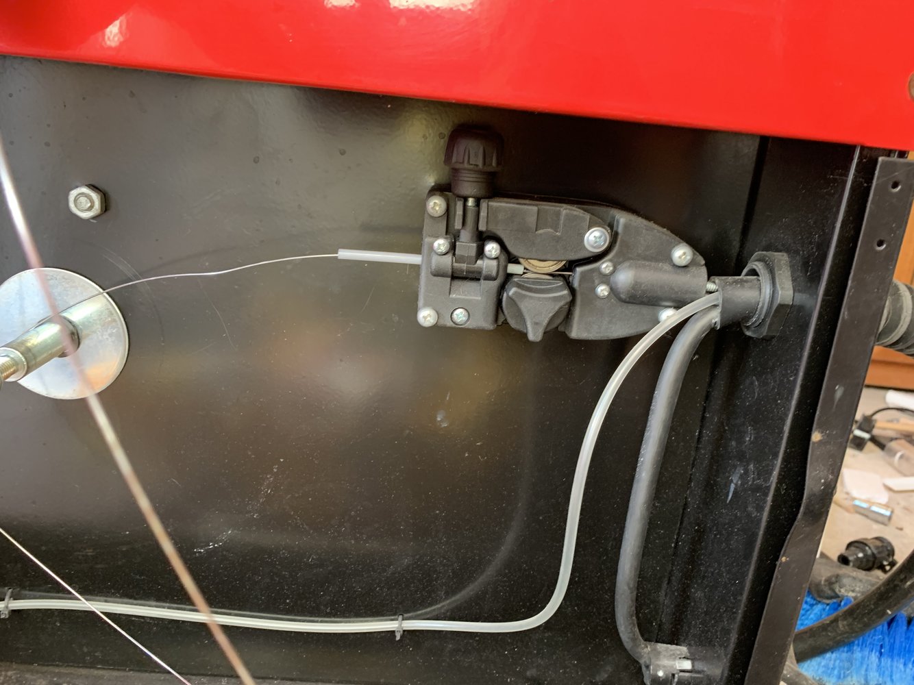

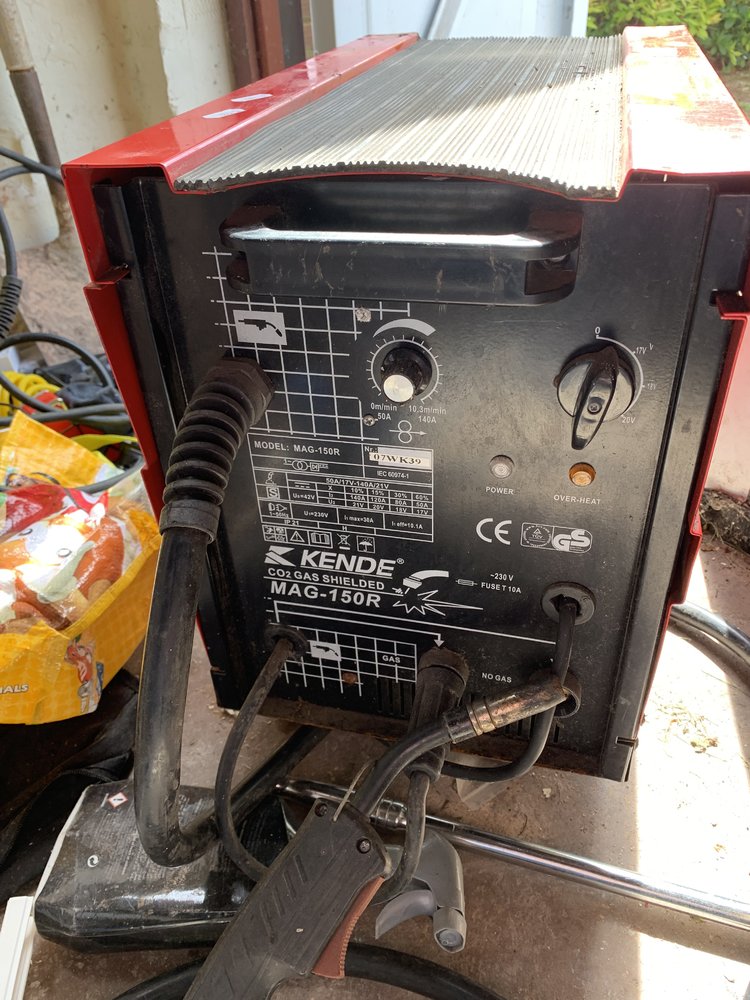

I’ve recently purchased a mig welder it’s a kende 150r mag welder. I bought this untested for £20 and have been gradually identifying its faults and attempting to rectify them. I’ve never mig welded before and don’t know an awful lot about the machines but I’m eager to learn. My research on this machine suggests that it used to be stocked at screwfix and isn’t the best but it was cheap and I think a good introduction machine.
I’ve identified the following issues -
Trigger Intermittent - fixed dirty contacts

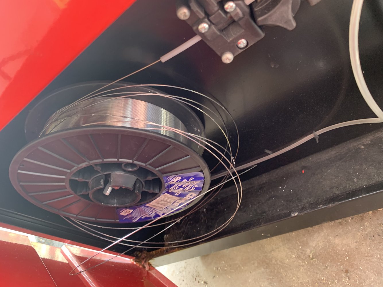

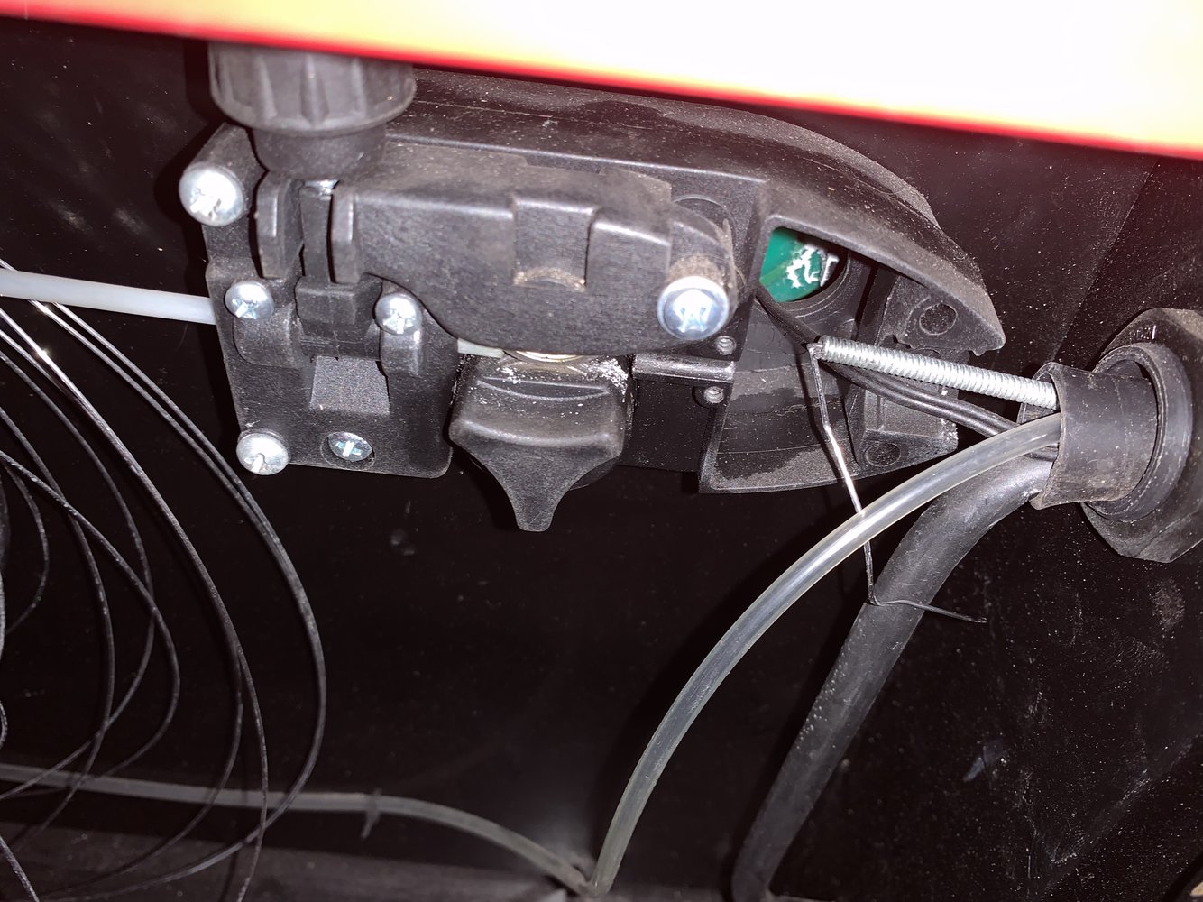

No wire feed - shroud and tip completely blocked buying new consumables when I work out size.
Tumbler switch for power faulty - I’ve read these (although tricky) can be dismantled and realigned. But spare part is available

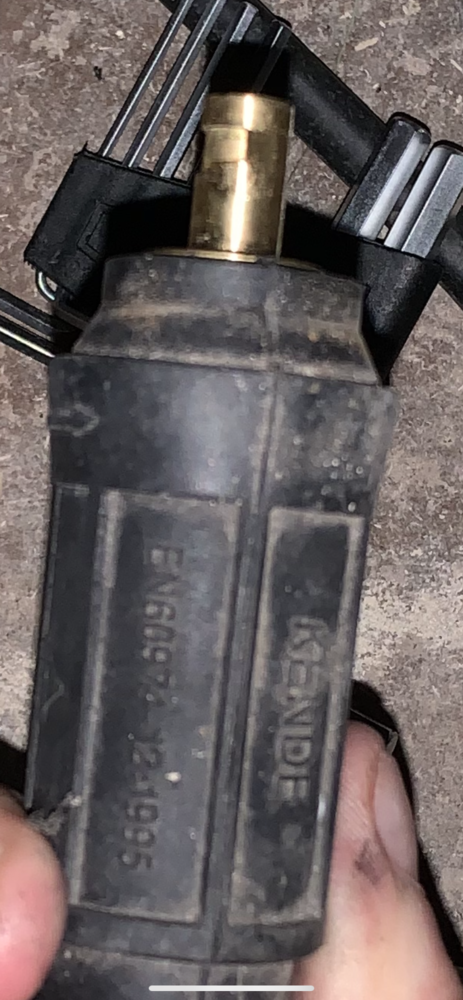

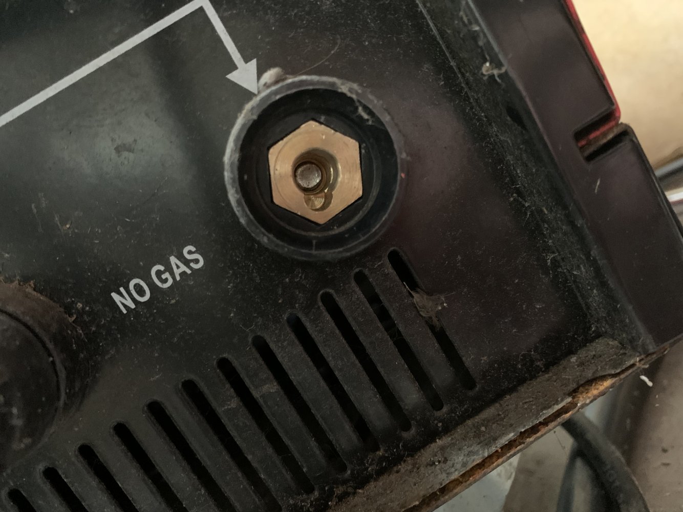

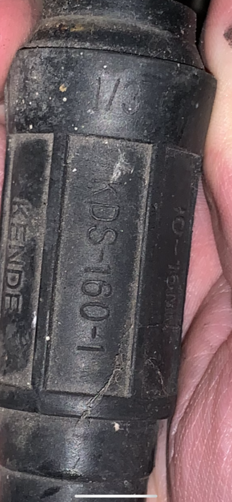

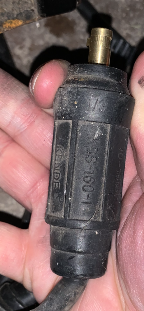

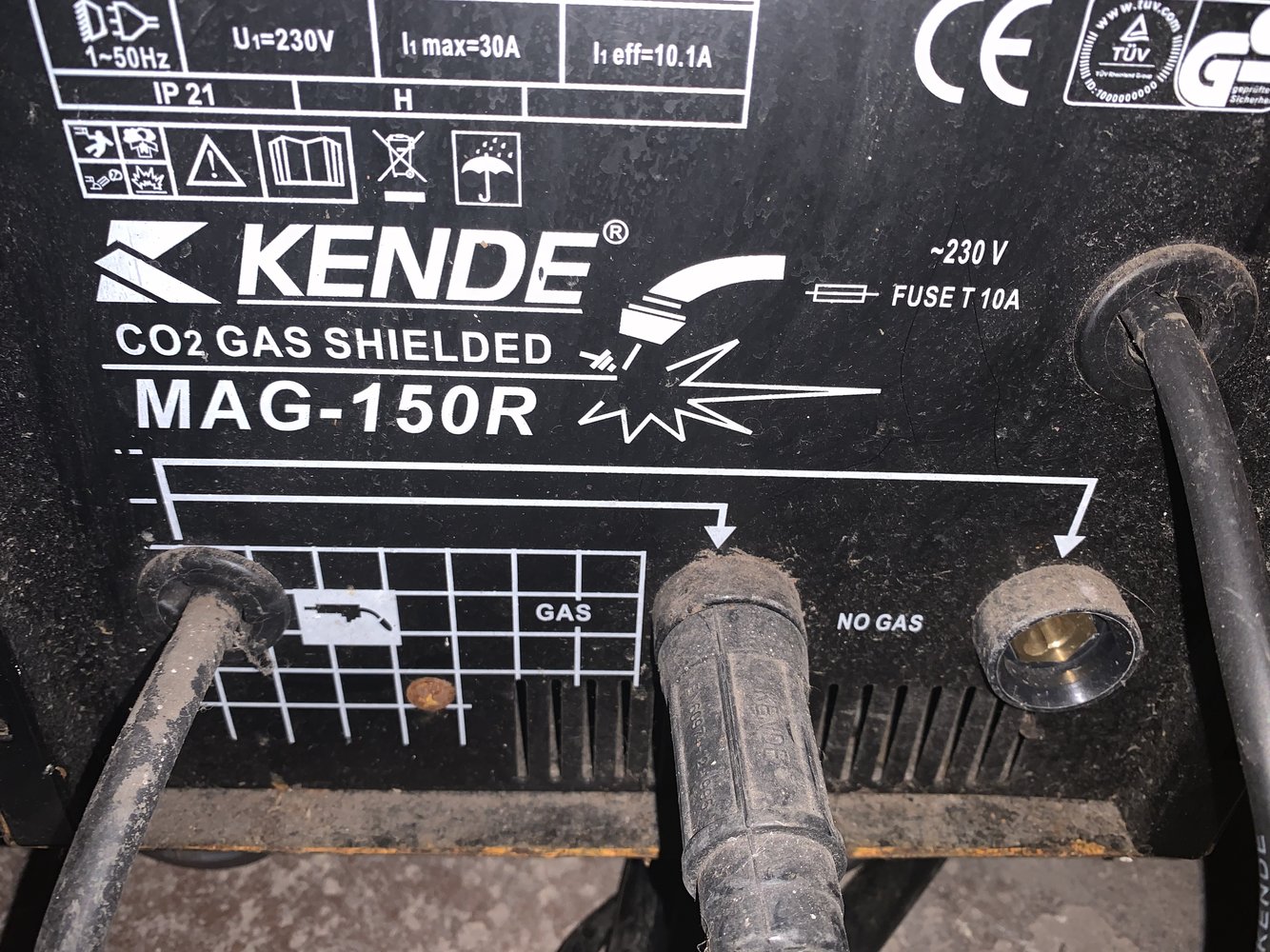

Biggest issue is that the machine came with no earth cable. I’ve took a gamble and ordered a 10-25 earth cable however this plus doesn’t fit. I know you can order separate plugs and sockets if necessary. The 10-25 appears to have a more rectangular shape where as this one has a semi circle and appears deeper. I’ll attach some images for reference.
