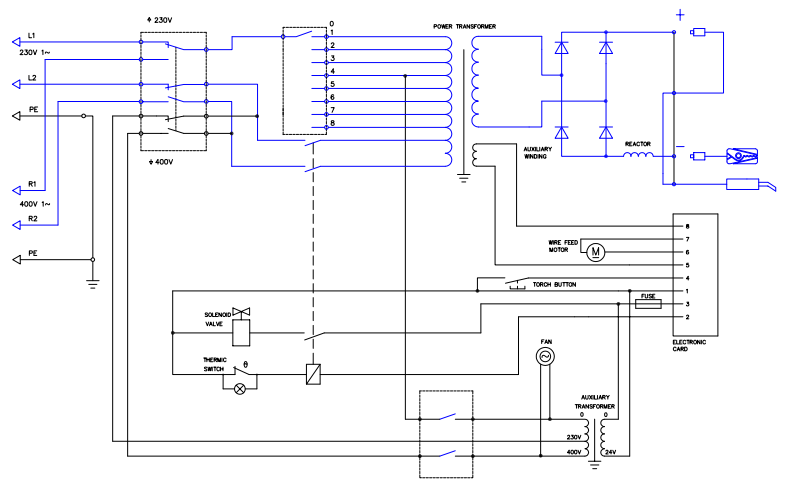

I bought a second hand mig welder that works on a single phase 230 or a 400v line. It didn't came with a fan. I acquired the schematics and it taps on the neutral and 400v line. I measure the voltage and it gives me +- 400v ( I only have a single phase 230v). Which fan would I buy? A 400v 2 wire fan? Any reference on the fan. I'm restricted to 160mm max.
