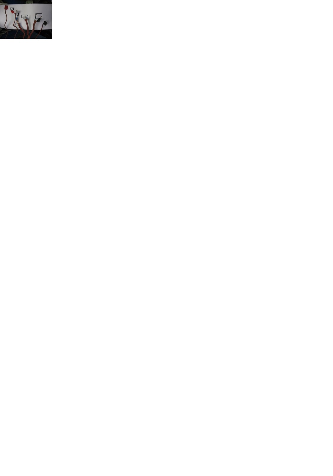

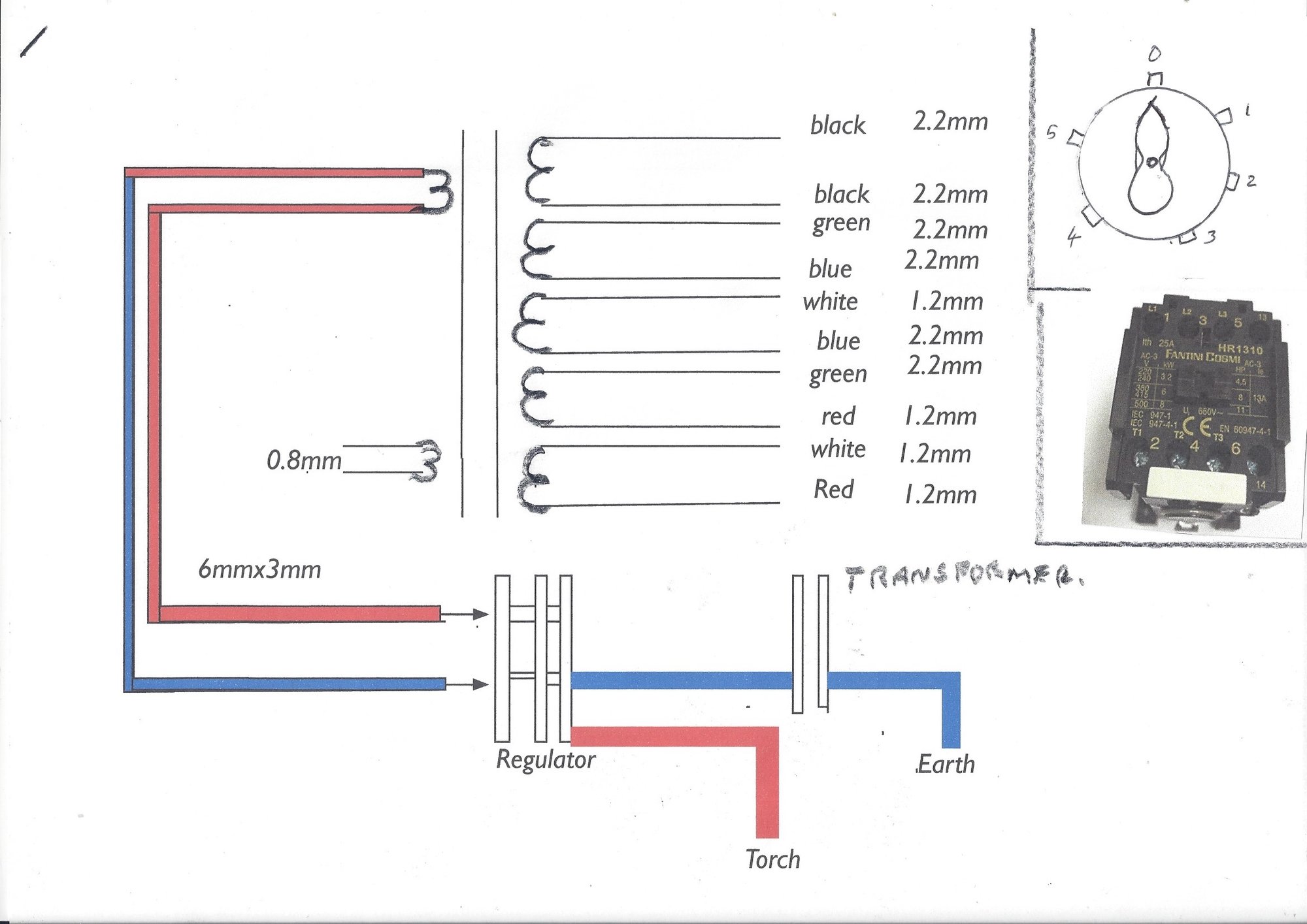

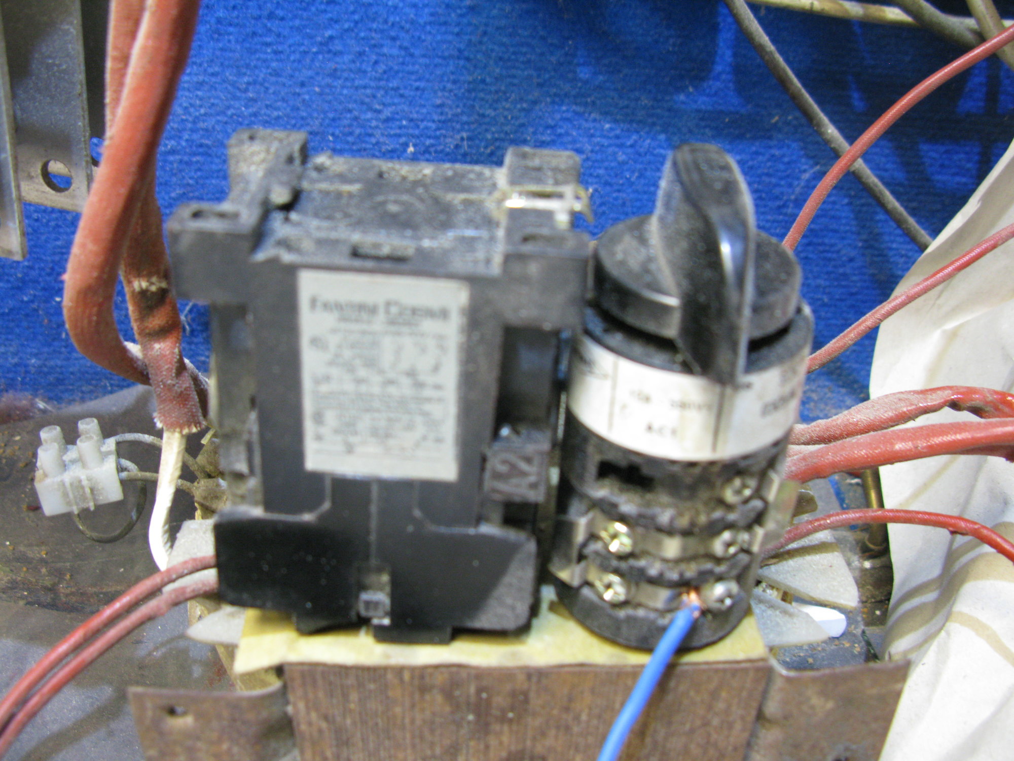

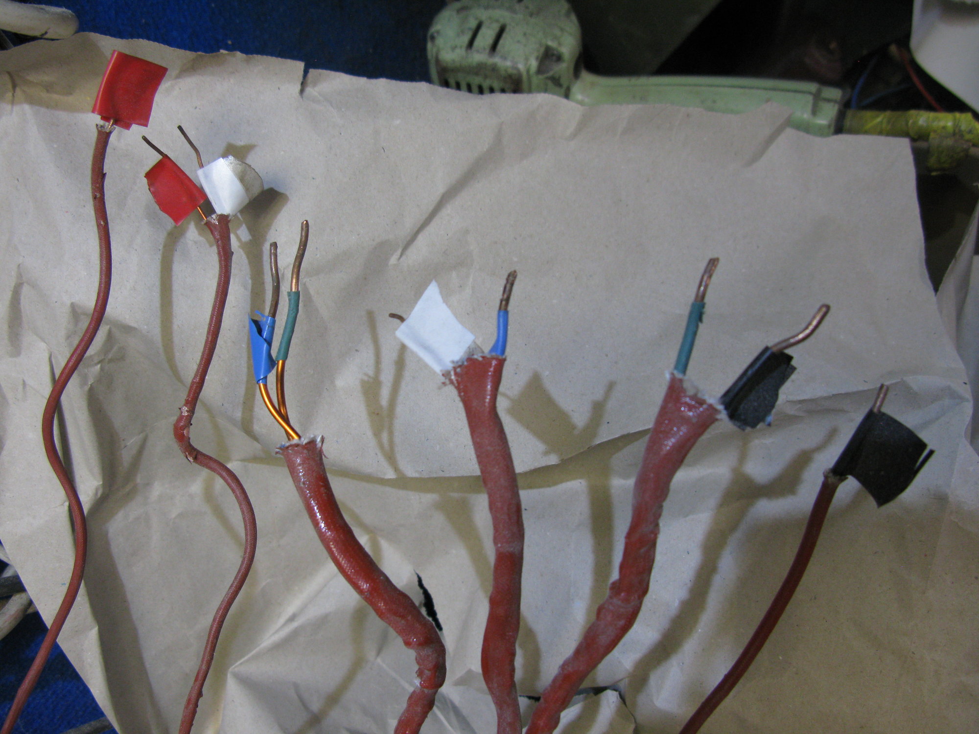

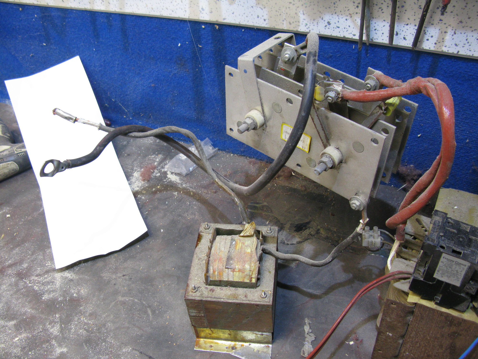

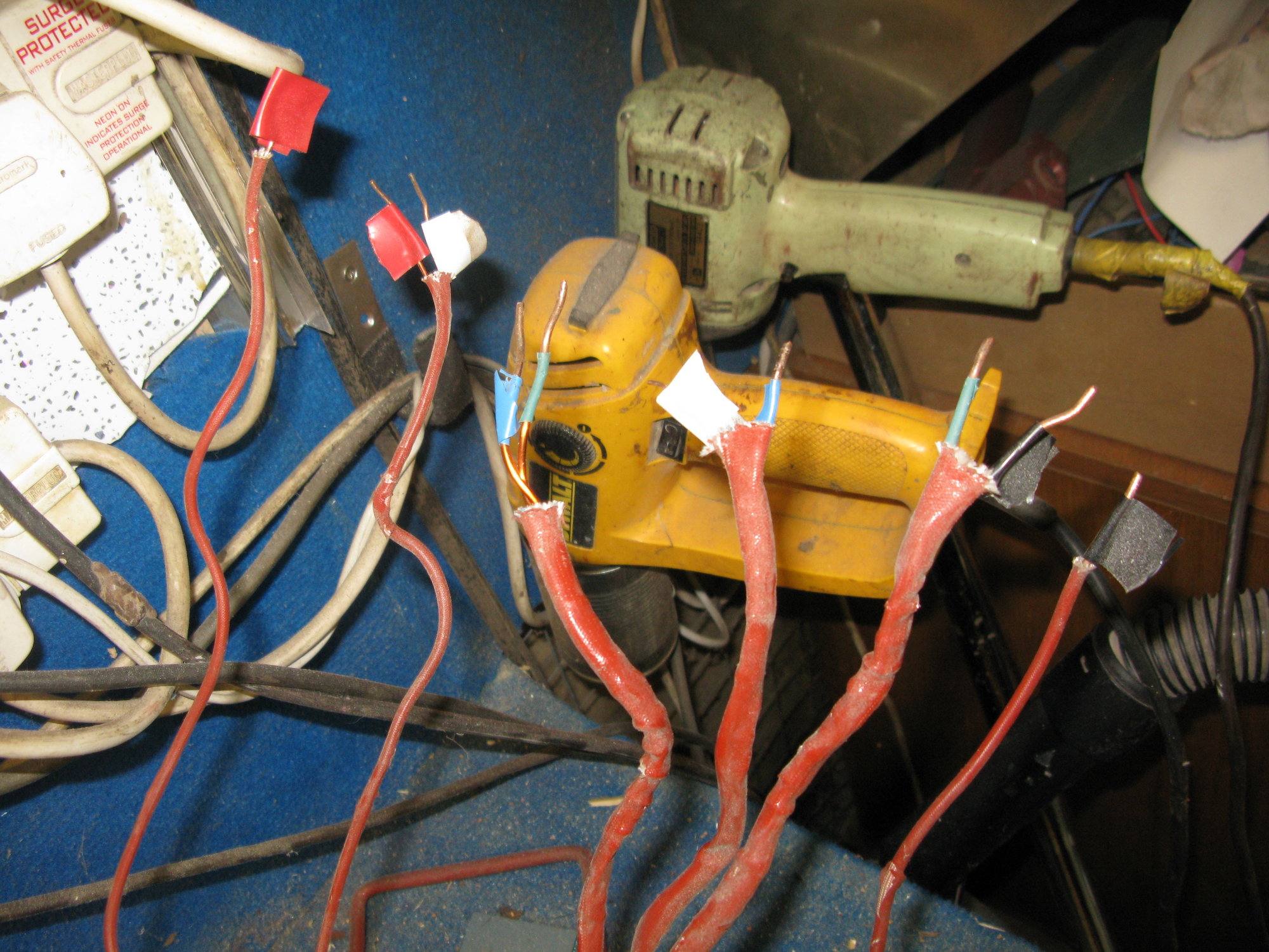

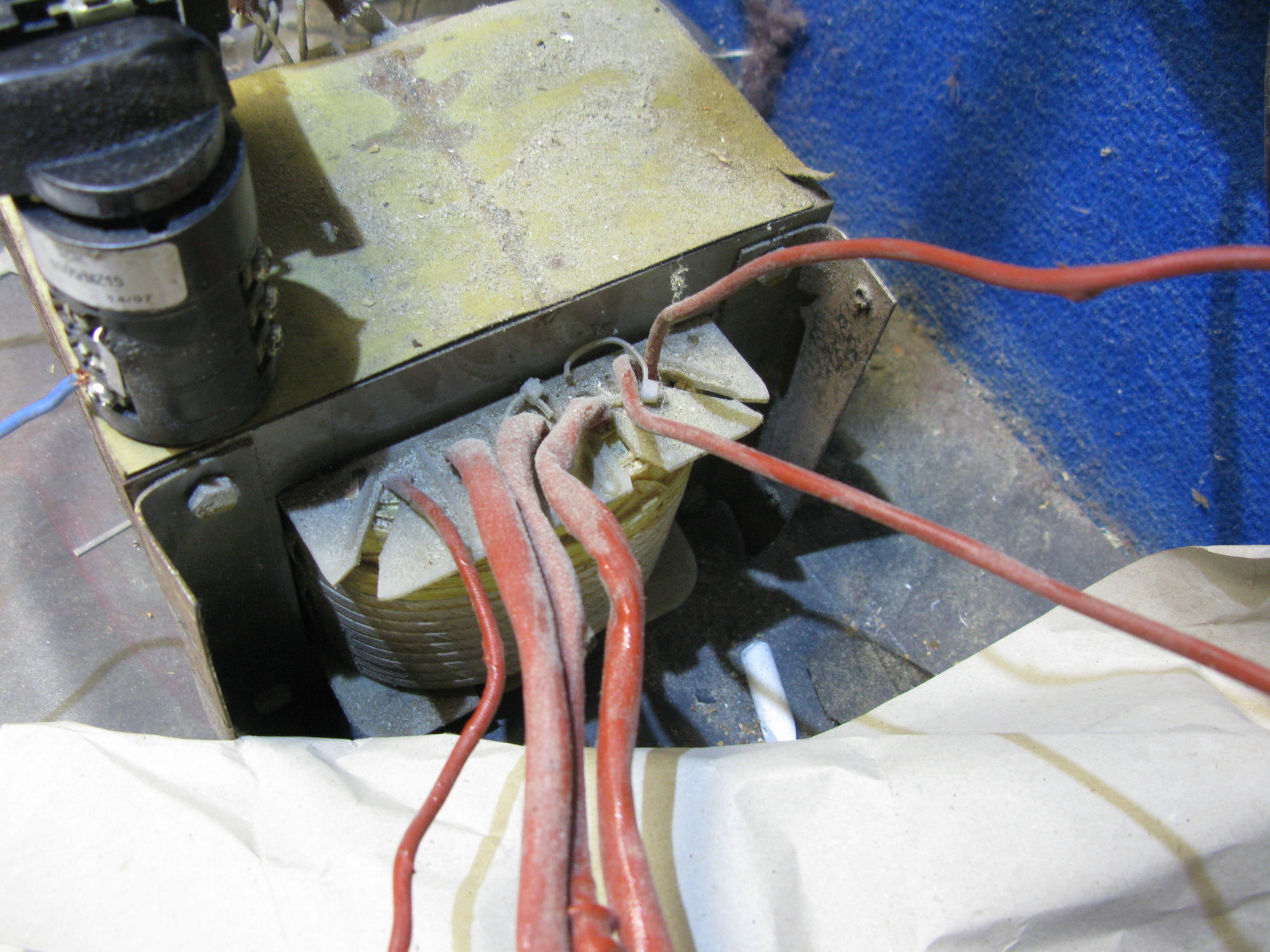

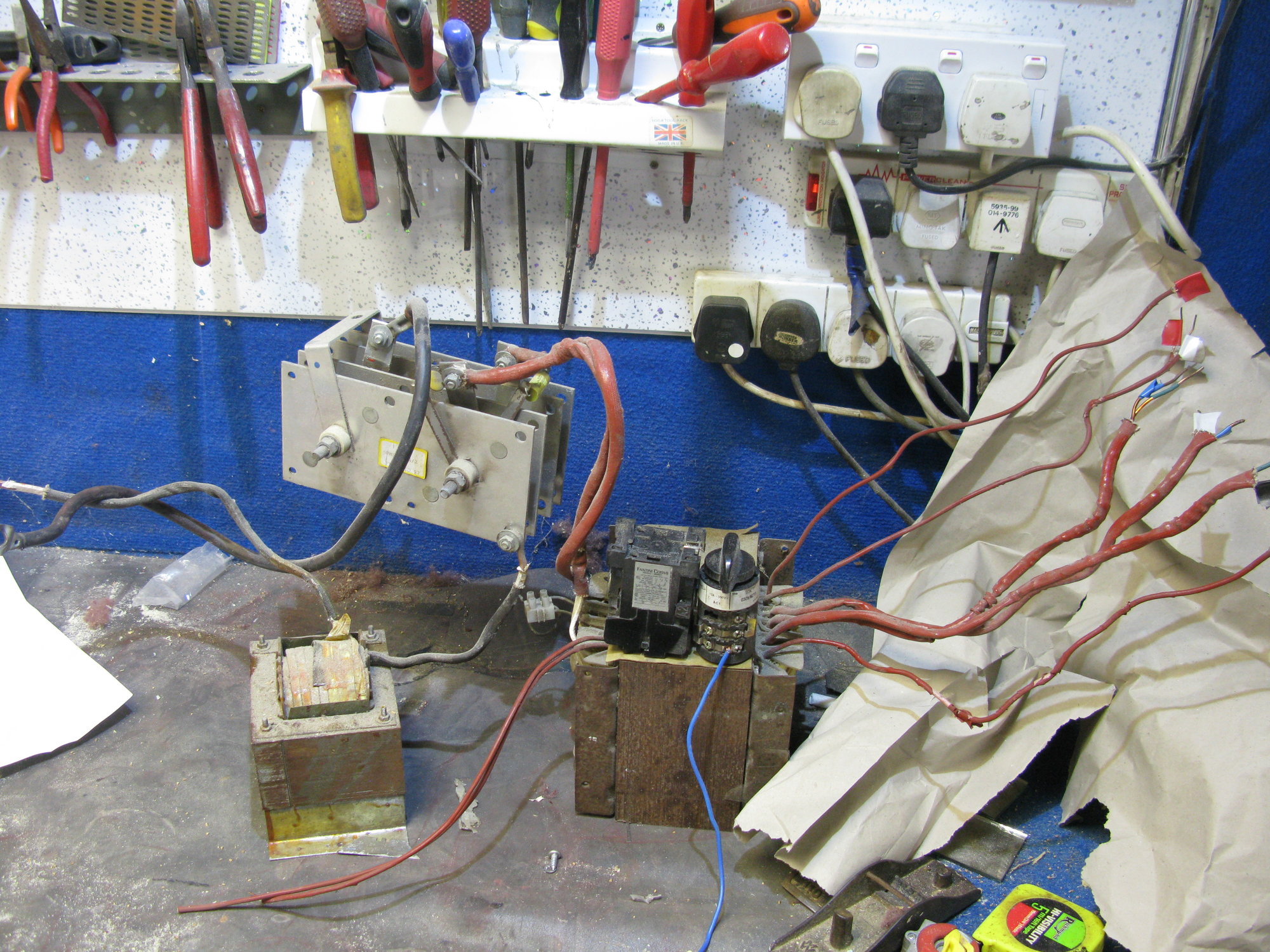

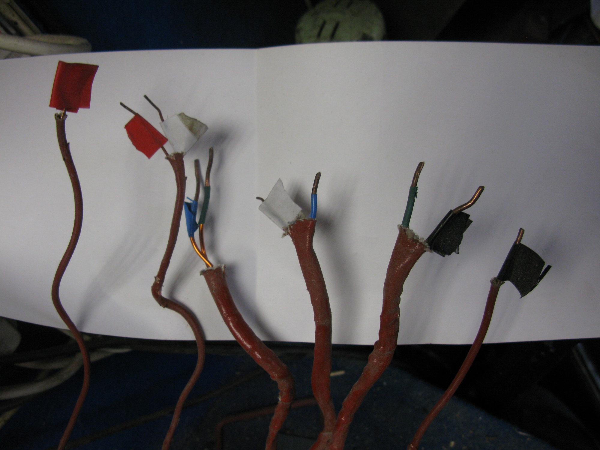

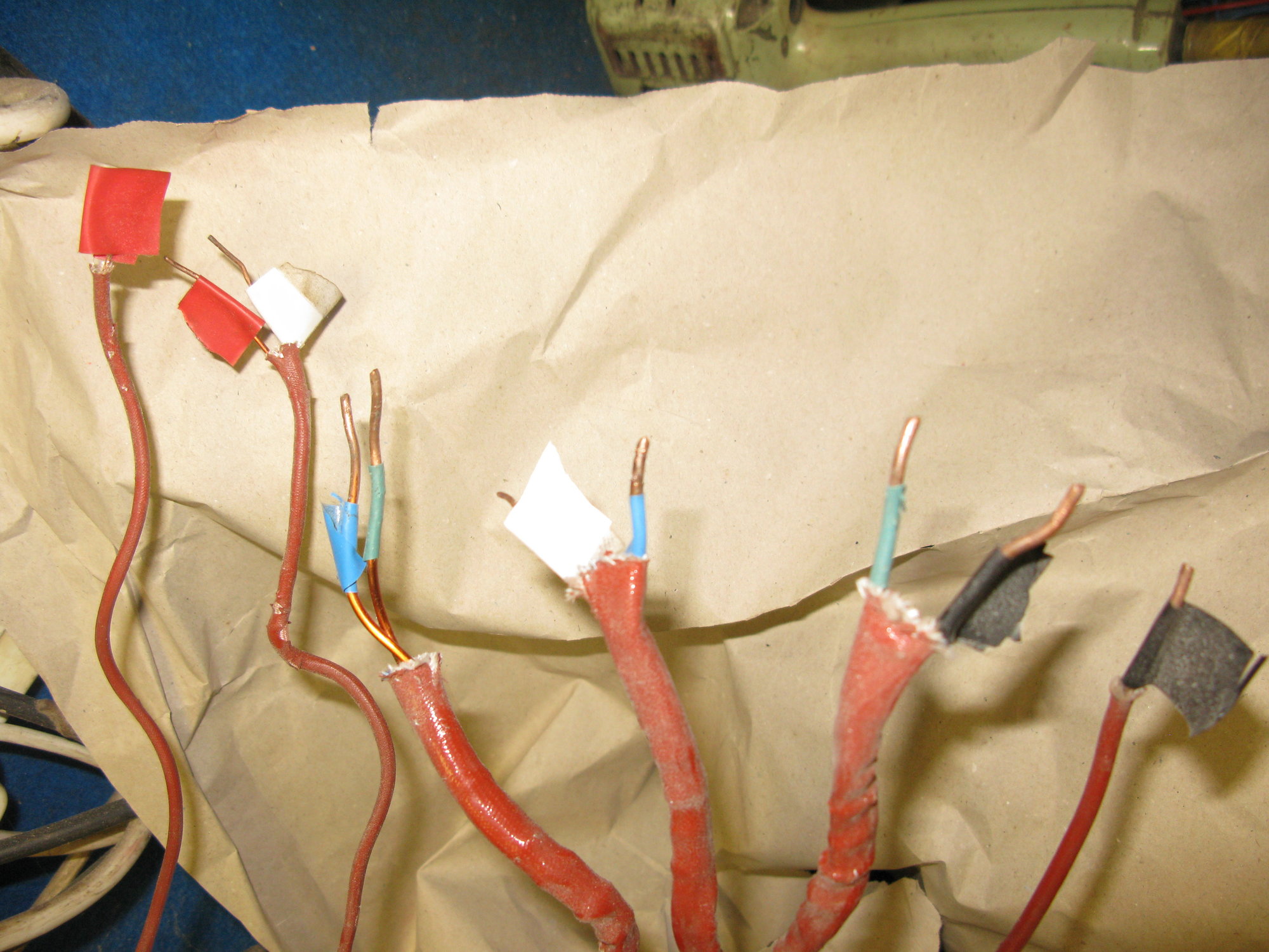

Hi All I am trying to convert a magnum 210 mig to a spot welder.i have constructed the arms and the copper electrodes now the hard part the wiring. Attached is a diagram of the setup i took out of the magnum 210 i have and photos
of the electrics on the bench + 5 position rotary switch and the big solenoid. I wander if anyone can advise
Mick
