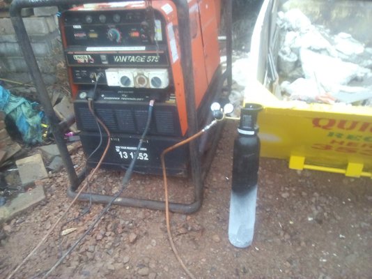

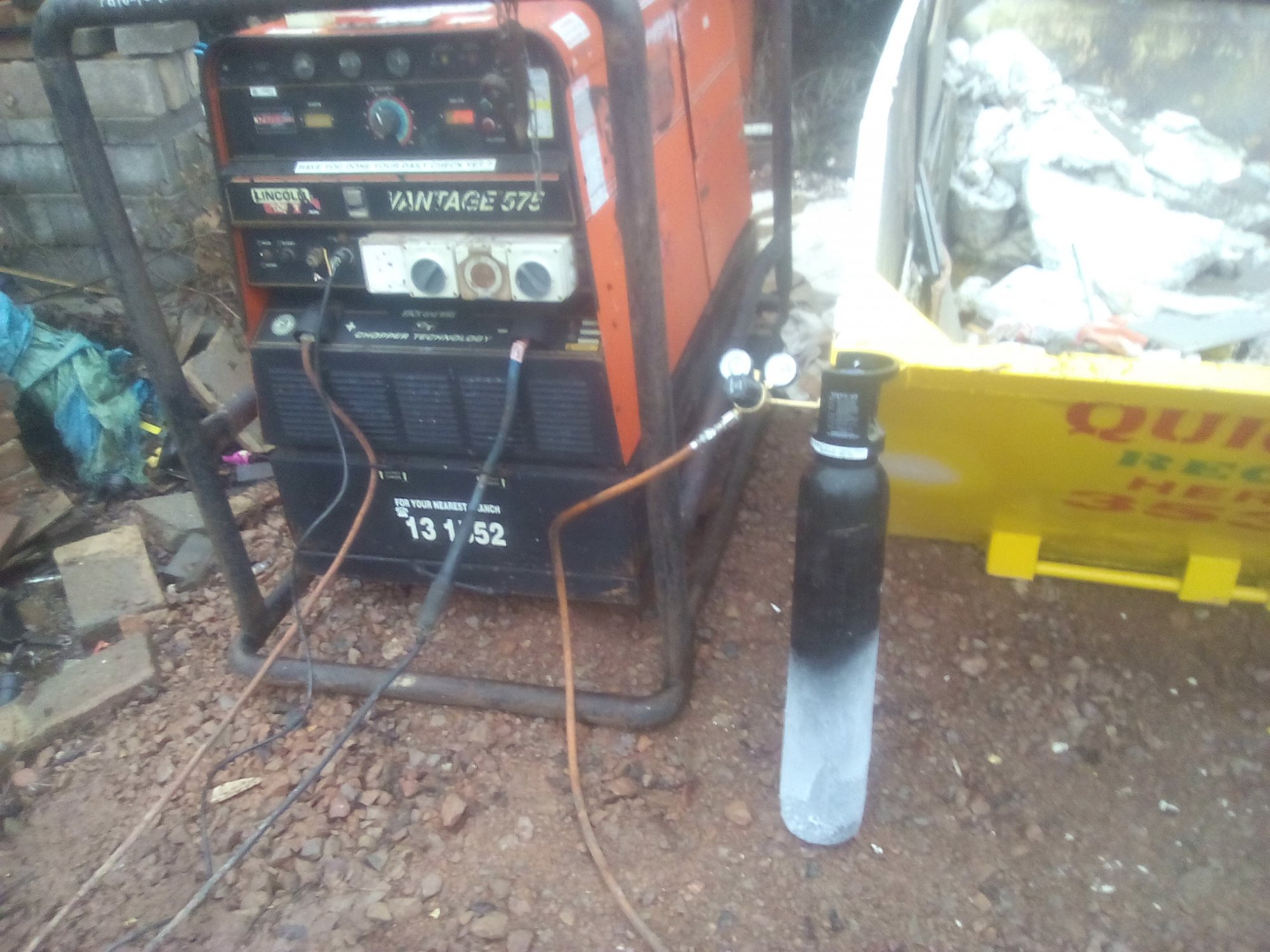

after dithering for quite some time about a portable mig that went out the window and i got completly distracted by overkill and got something completly diffrent, its really its all hughF's fault by putting the idea of engine drives in my head. so in the end went and fetched this thing
seems to work all right so far, but amphenol connetors ae a twerp spent a fair while getting the right one to connect the remote to it, turns out it was only nearly the right one the end result of this is i now need to change the socket on the welder but it wasent looking over healthy anyway and i orderd one at the same time just incase this happend.
the plan ( now tested ) is to connect up a wire feed, i was going to copy hughf's project and build a suitcase feeder, but as luck would have it searching for donour machenes i found a Butters AMT 500-4 remote wire feed. it was fully functioning till i might have driven a tek screw though the selonoid coil for the gas valve rushing things.....
but now i've had th two conected together and working, can start sorting out the niggels hopefully
