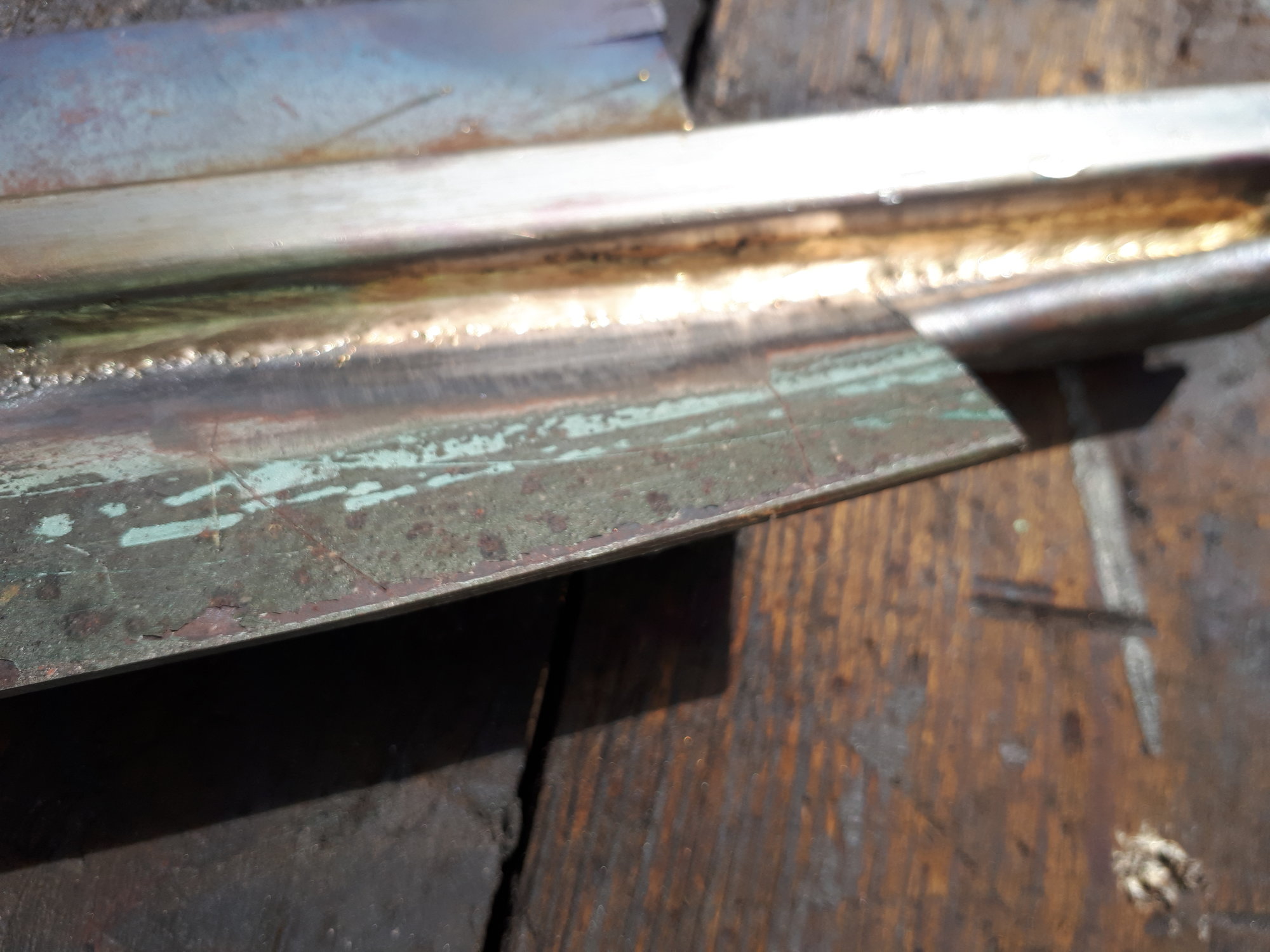

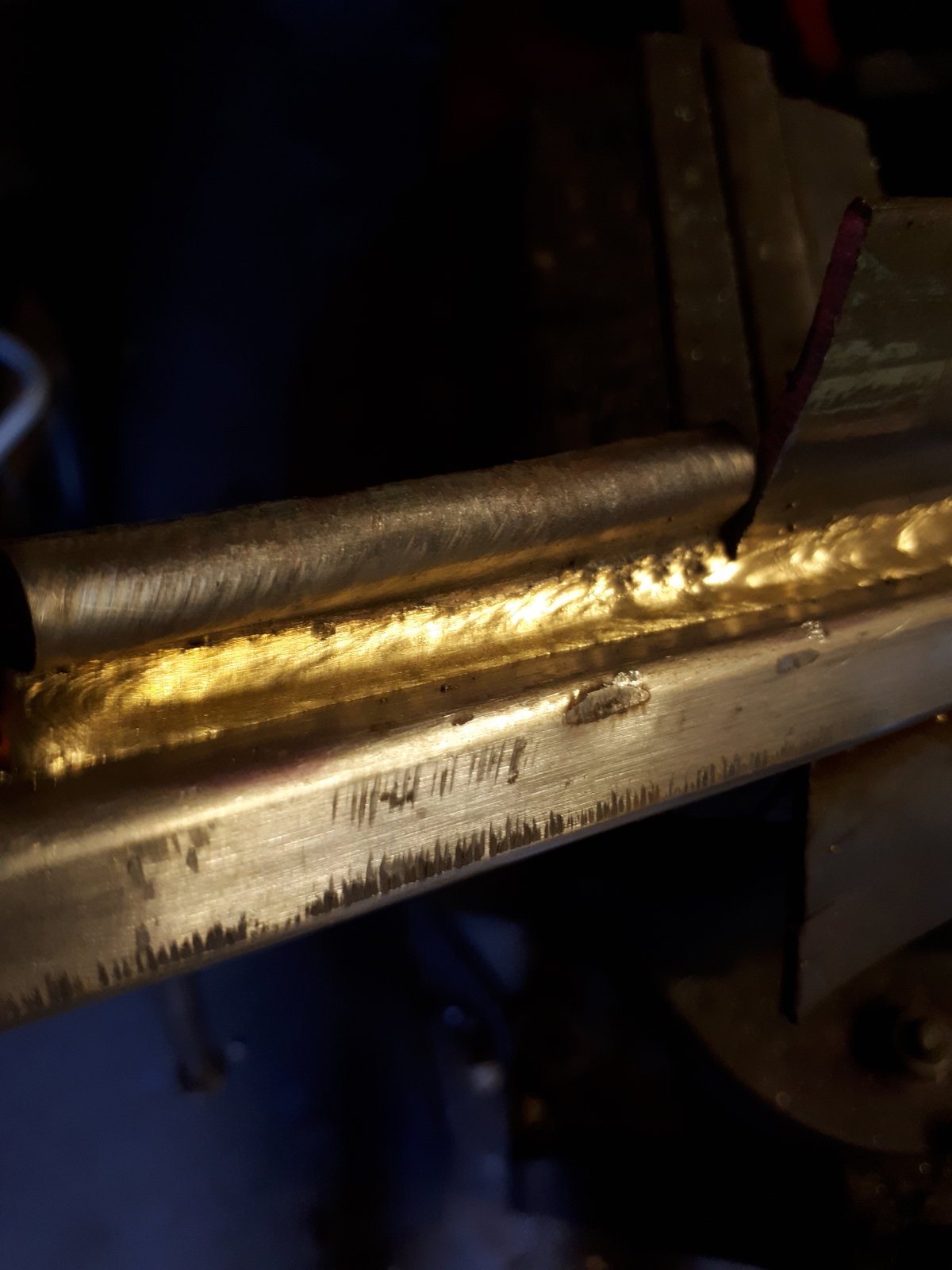

Had an old reel of 0.6 which i think is alu silicon bronze
i set up the oer llikon m308 on pure argon volts 22.7 wire by sound .
Material was 3l6 box l.6 wt and 2mm ms plate it worked well and i bashed it about with A large hammer but it seems very strong theres a few pores with it picking up dirt and paint off the ms side but its spot on on the 3l6 side looks like handy stuff
