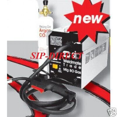

I can't believe it hasn't got a control on the front panel but if not then it must auto adjust the speed as you adjust the voltage. There may be a pot on the PCB you can adjust
What machine is it and can you post a pic of the front of it just for reference?

For the wire speed, many welders automatically adjust wire speed with power setting. But all have knobs for the wire speed as it does need to be adjusted for different welding positions.

I'm really sorry day101 but I reckon you've got a £100 lump of uselessness .
You only have two settings, 40A and 80A so you're really limited as to what you can do with it.
My advice is to get rid of it. Sorry if that sounds a bit blunt but even if you get the wire speed running reasonably it'll still not be much good for car stuff at 40A minimum, you'll blow holes left, right and centre
