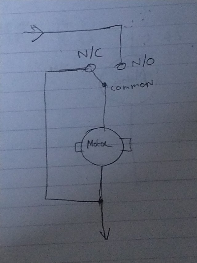

You've wired the relay incorrectlySo I tried to brake it through a relay so when relay is off it shorted the motor out -
But all this did was blow the fuse on the pcb and second attempt took the transistor with it ??

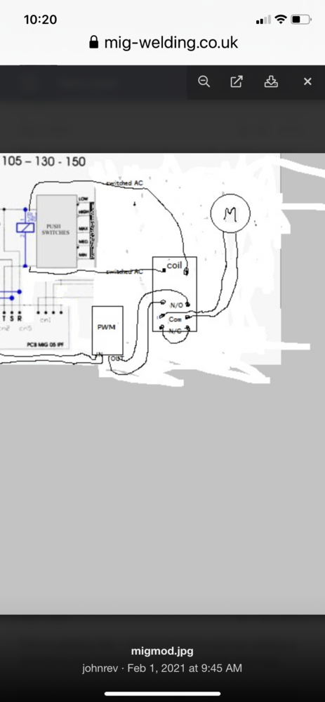

No that'll be fine, just use one of the poles or parallel them (common - common, N/O - N/O, N/C - N/NC). DPDT I normally associate with toggle switches, the relay equivalent would be a dpco - double pole changeover though dpdt and spdt are common as well. It's all part of history and some use is hard to forget. I still use squiggly lines when I draw a resistor as wellI did it with a dpdt ? So that’s the wrong one
So doing it like how the sip mods is done is wrong and that’s why it took the fuse and tranny with it , I basically fed the motor power through the relay when it’s switched on and then when off it’s just the motor and then shorted itNo that'll be fine, just use one of the poles or parallel them (common - common, N/O - N/O, N/C - N/NC). DPDT I normally associate with toggle switches, the relay equivalent would be a dpco - double pole changeover though dpdt and spdt are common as well. It's all part of history and some use is hard to forget. I still use squiggly lines when I draw a resistor as well![]()

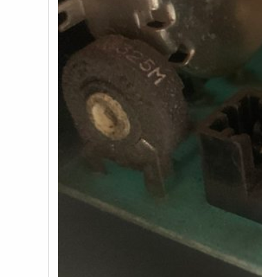

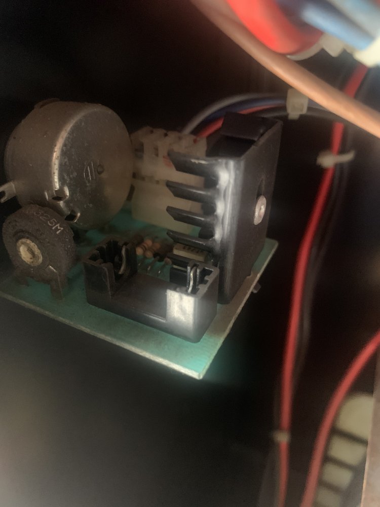

Yes bud to much stick out - bloody sticks to the weld so have to arc again to get it off - only pot is for the speed adjustmentBy 'over run', mate - do you mean insufficient burn back = too much stick out?
Possibly this is tweaked by the board pot? ... I'll let our new star above, DSR, pass comment on that. Too electronic-y, for me.
Set it on power setting 1 and did it so it was just crawling on speed controlI did it same as this
yep that’s the one
That's another way of doing it with the DPCO (DPDT) relay you have

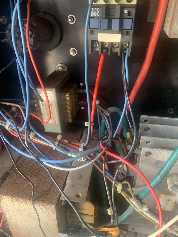

Thanks mate , I know what I done wrong , I’ve just gone to it and looked at it and thought you daft bugger I’ve got the motor ( common) and power wrong way round ( muppet) but to be double sure I used the two unused contacts on contactor and put positive feed for motor and pcb through it and it’s working brill - yet again DSR Thankyou , you guys are brill and I owe a few pints out .That's another way of doing it with the DPCO (DPDT) relay you have
If you wired it like that it shouldn't have burnt anything out. Make sure that the pin layout on the bottom of your relay is exactly as in the diagram.
Set your test meter to lowest ohms/continuity range) and check that Common - Normally Closed is 0 ohms and that common Normally/Open is 0L or open circuit. Do this for both pairs of contact.
Then, with the relay energised, e.g. if it's a 12V relay, connect 12V across the coil test Common - Normally Open is 0 Ohms and Common Normally Closed is 0L or open circuit.
