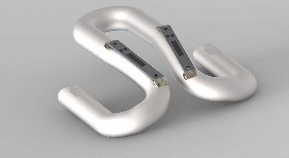

I seek a subcontractor to weld a 430 Stainless steel strip (50mm x 7mm x 1mm thick) which has been printed with a thick film strain gauge to a 16mm round steel spring bar (material 56SiCr7).
The strip is parallel (50mm side) to the axis of the bar but will sit tangentially on the bar surface. The weld needs to be at the end of the strip and the heat effected zone needs to be less than 8mm from the ends. Initial trials will be aimed at 10 prototypes but production will be in the low thousands.
Has anybody any experience of such a technique or is anybody willing to have a go?
