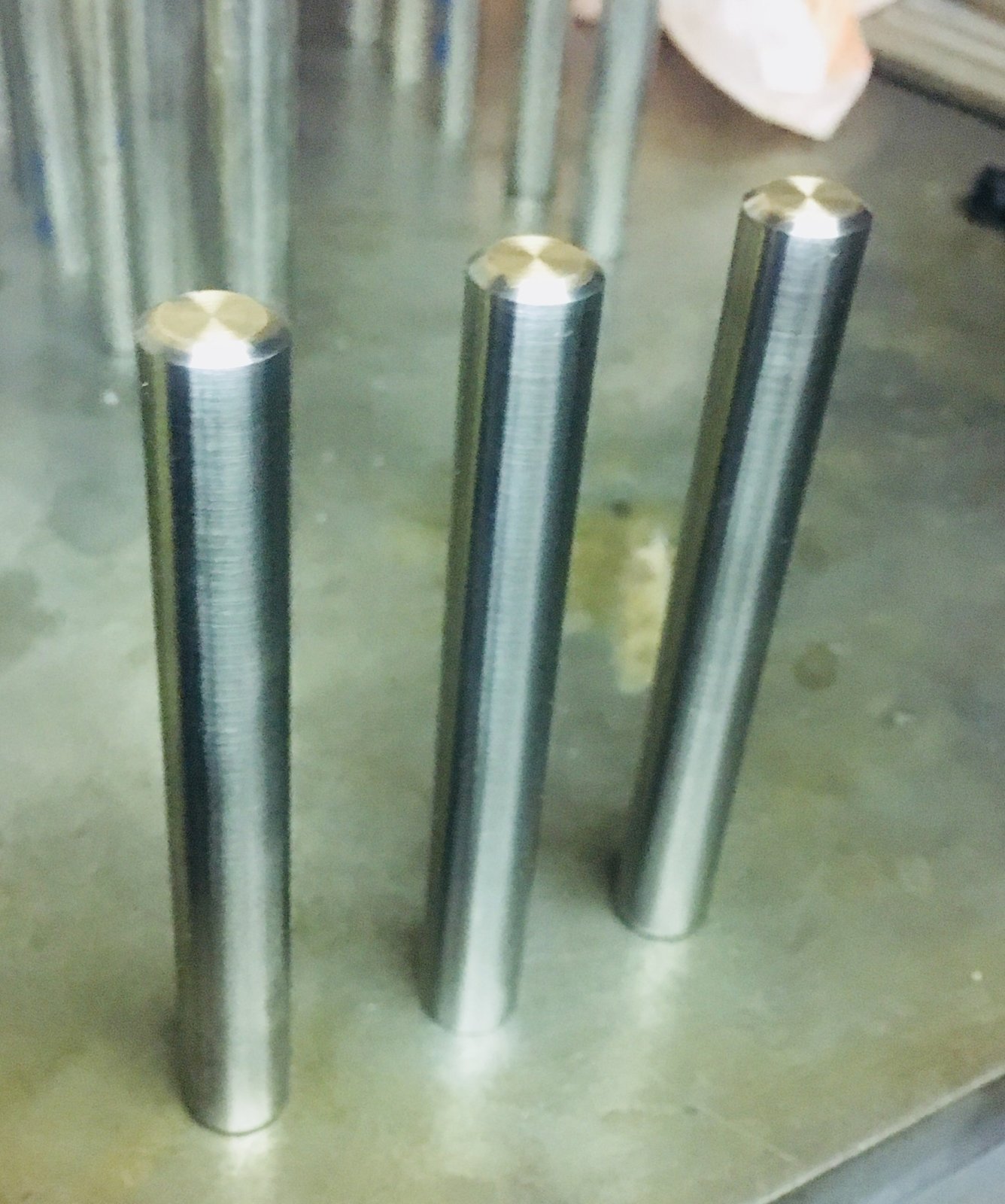

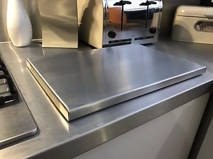

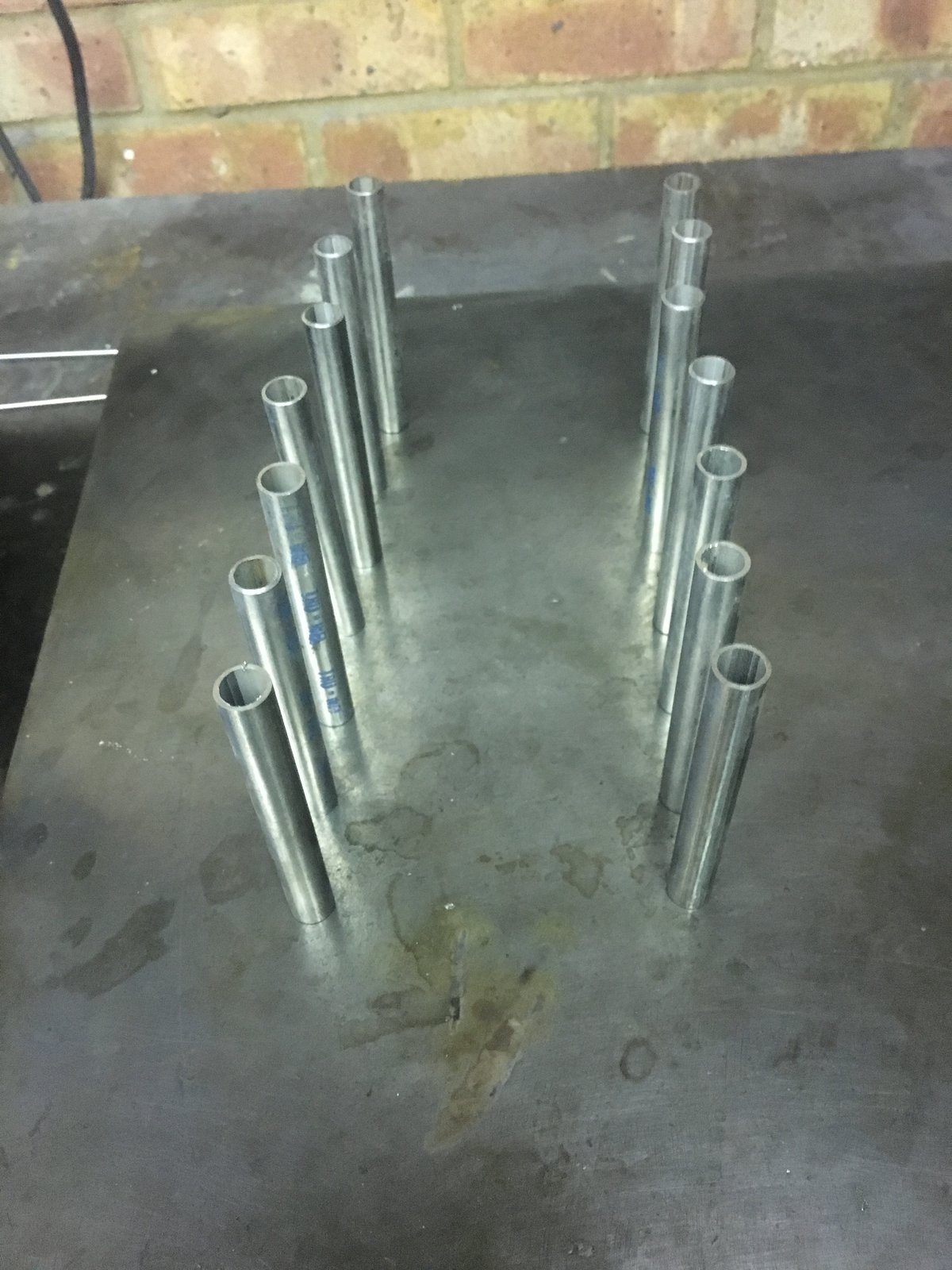

I think it looks brilliant I might have to copy itKnocked off work at 5:30 and bashed this out
I’d have no problem whatsoever having this sit in my kitchen. It looks simple, clean, straight and modern. More importantly it’s fit for purpose.
Might not be to everyone’s taste but I think it looks pretty nice.
Your thoughts positive or negative are very welcome. Hope mums pleased.
Cheers mateI think it looks brilliant I might have to copy it

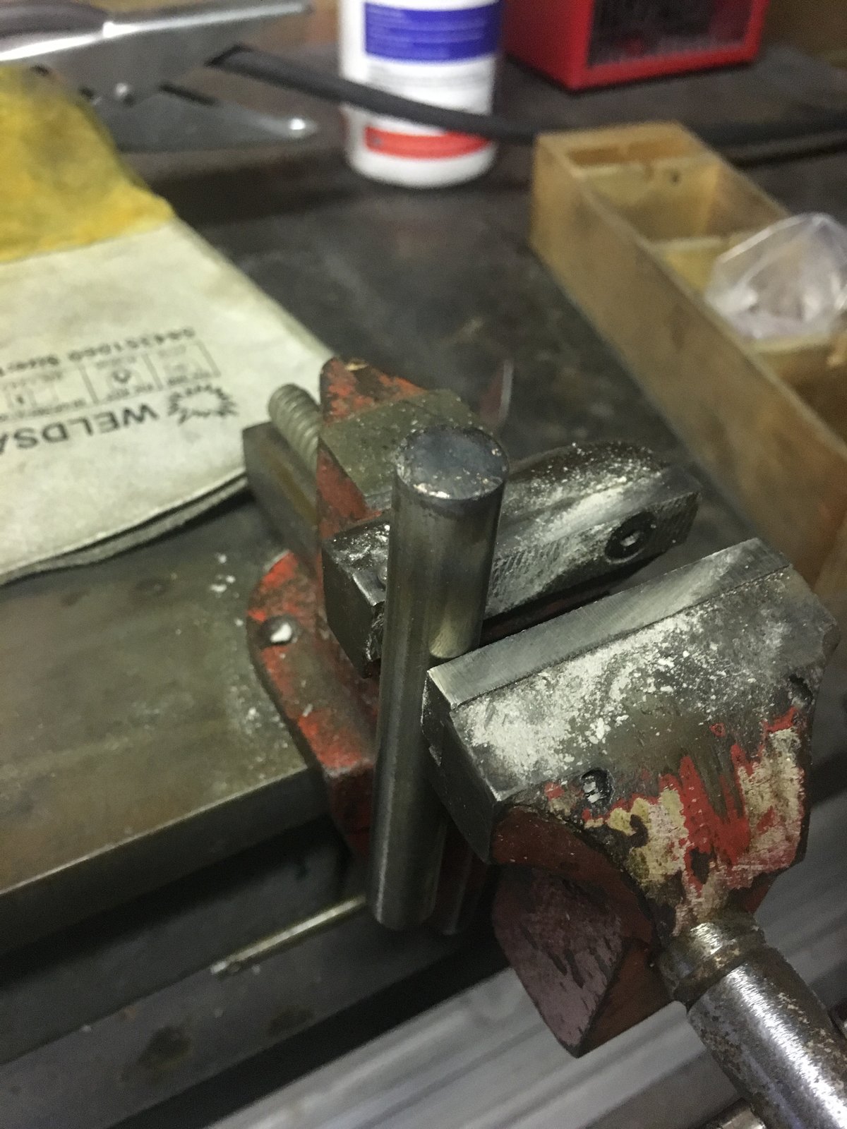

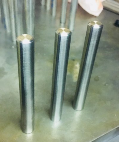

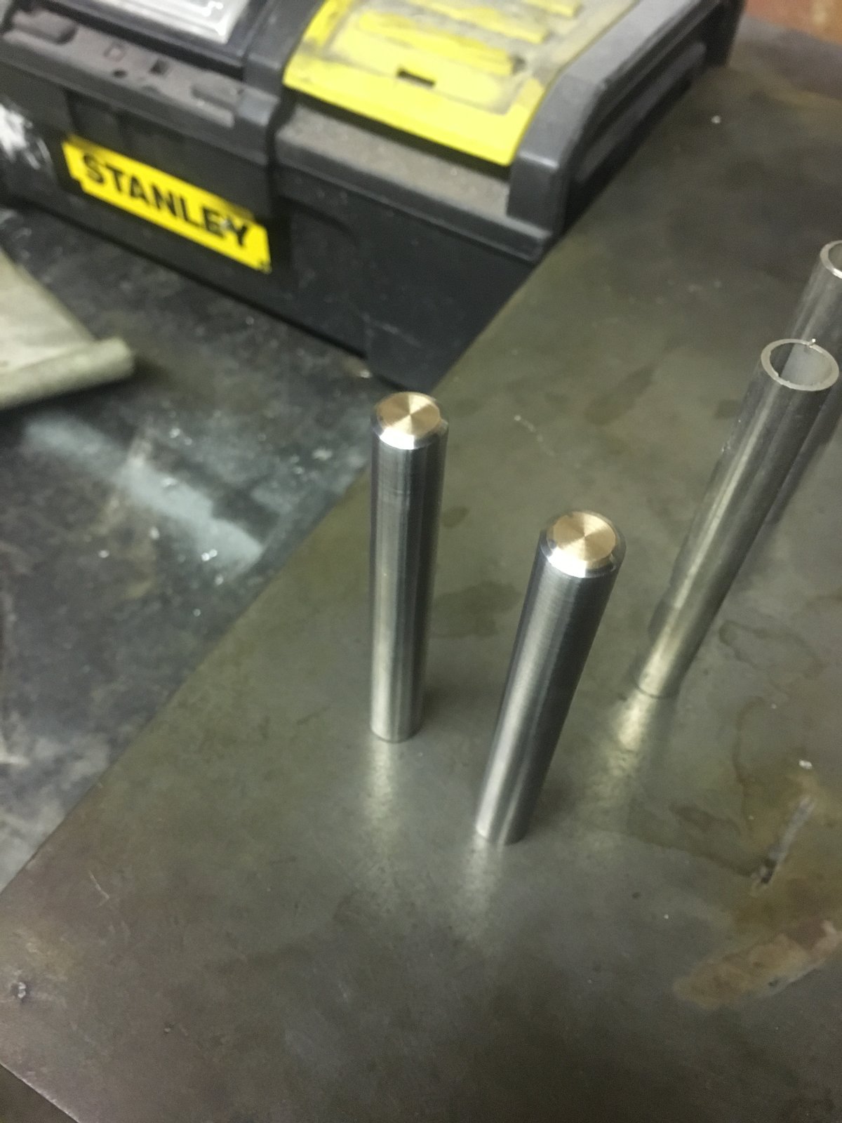

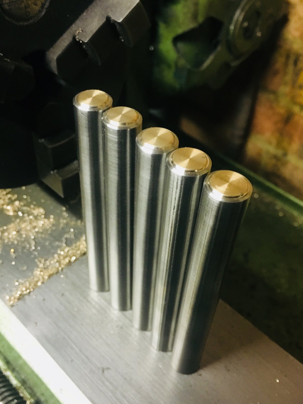

Wondered when that got asked.How did you attach the uprights to the bottom frame
Good idea looks like something that would cost a fortuneWondered when that got asked.
With the best will in the world I’d of never welded them and kept it flat. No chance. So I pressed stainless nuts into each tube. Drilled and countersunk the bars then assembled them together
I loctited the two faces and the thread fully so that it’s a complete seal. No water or anything is getting up those tubes and it’s obviously remained distortion free.
If I bought it all yes it would bear a significant cost. However it’s cost me about £10 in brazing rods and stainless m6 hardware.Good idea looks like something that would cost a fortune
I’m not. 9 is plenty.Im waiting for she wants another tier
