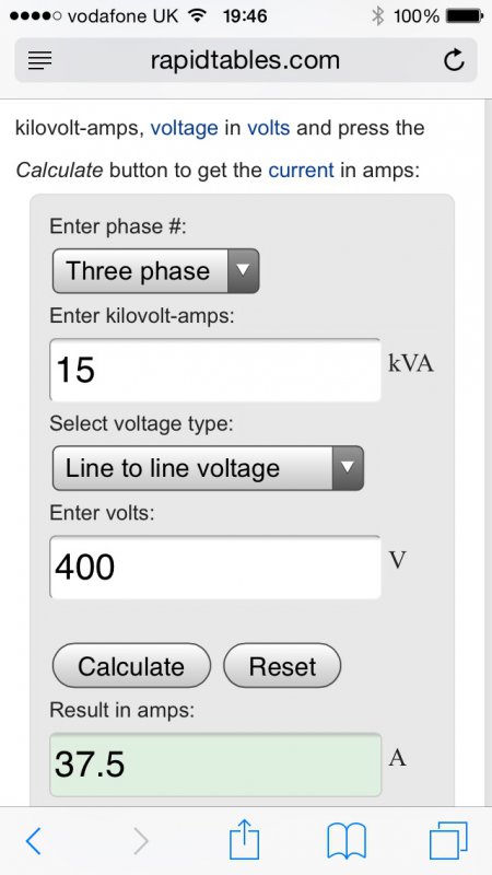

Jim Davey ' a quick question ' does the same maths formula apply to working out the size of generator , for running a 3 phase welder as it does with a single phase plant?? and if so what amps 3 phase suitcase mig could a 15 KVH - 400 amps Genset comfortably run ?? Regards Mark .
I'll tell ya what jim Davey " your a star ' thanks for that , I will be looking that one up on google !! Just looking at the GenSet's on MHM 's ebay site trying to convince my self to go for the expensive one with 110 , and 10 Kvh of single phase as well as 400 amps 3 phase but it's another couple of grand more ?
