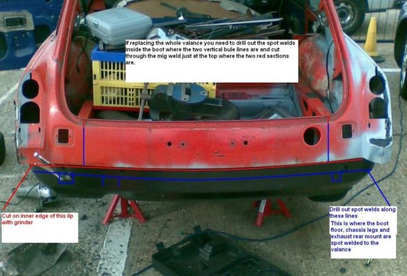

Hi there I dont know if this is the right place to put this but here goes.
I have done a fair bit of welding but all agricultural chassis repairs and big heavy stuff. Now I have to replace some panels on a mgb ( The rear valance) which looks to me to go all the way up to the boot lid . Has any one ever replaced this panel and can give me any advise on how to cut it out to start and replace it
If any one has done a mgb please let me know any help will be appreciated
