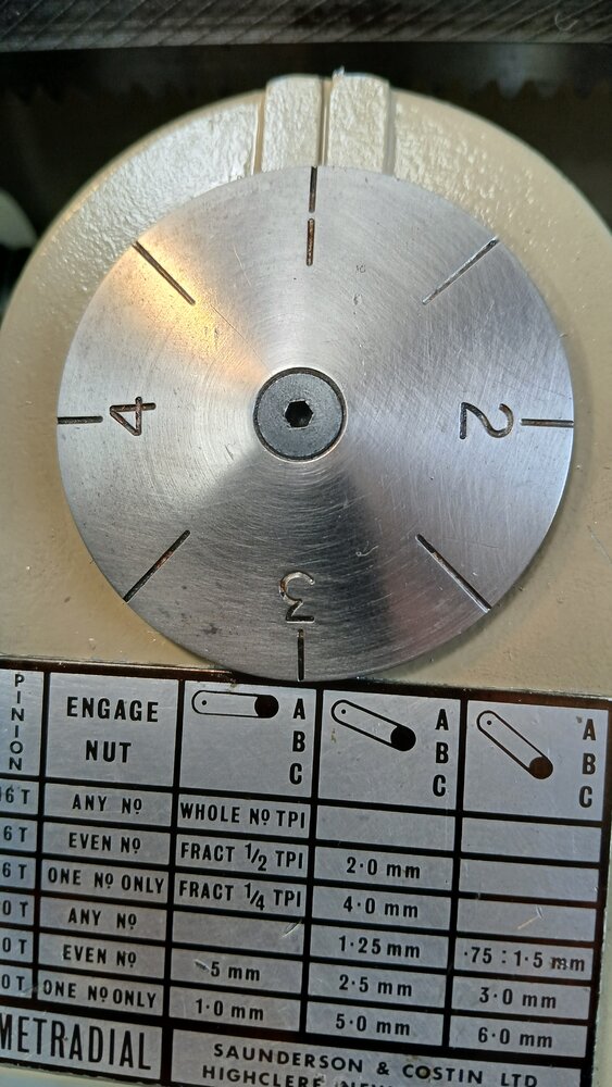

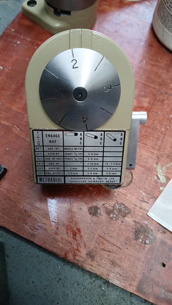

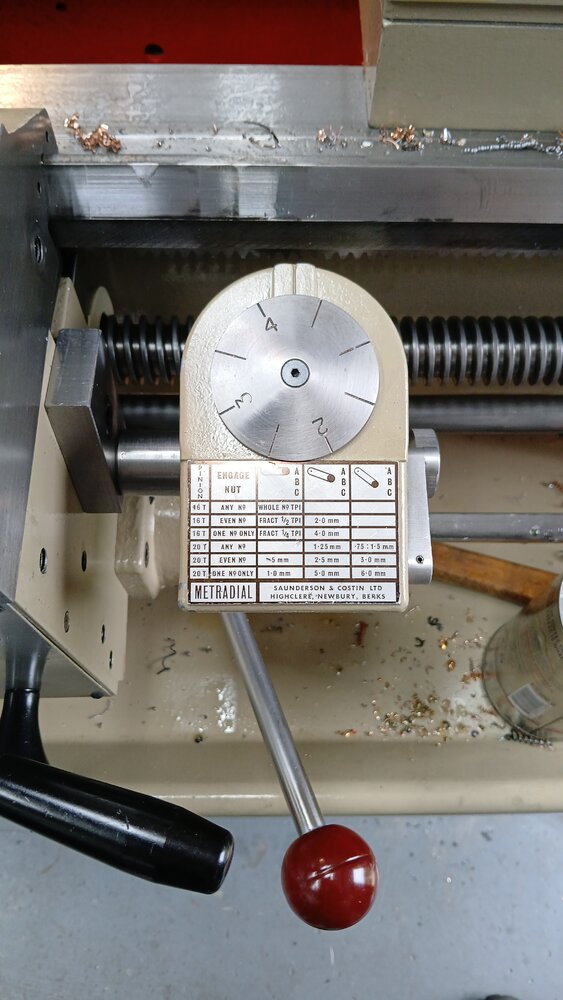

I have this threading dial that came with my recently(ish) acquired Harrison M300. It's a bit bigger than a standard Harrison dial and doesn't fit on the lathe using the standard mounting hole for the threading dial. It was attached to a shop made adaptor plate on the side of the Ainjest attachment:

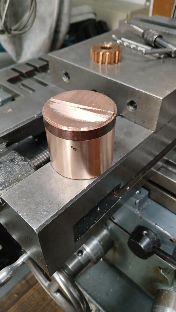

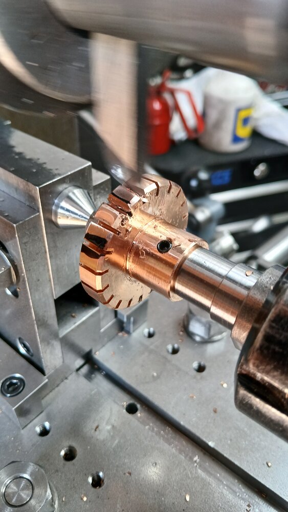

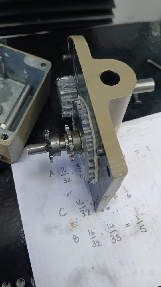

I've taken it apart, cleaned it, painted it to match the lathe, then decided I fancied a standard looking dial so machined up a replica of a standard M300 one. I thought I'd list this one for sale as I didn't need it. But first, to make it more attractive to sell, it would need the 20T pinion listed on the data plate. I assumed that this would interface to a 6mm pitch leadscrew, so I made the blank 42.1mm OD, by my calculations the correct OD for a 20T gear with a 6mm circular pitch. Its wrong on several counts.
This morning I thought I'd write a spreadsheet to verify that 6mm was indeed the pitch that this box of tricks was designed for. For the uninitiated, me included before I sat down to work all this out this morning, if the leadscrew would move the carriage a whole number of "to be cut" thread pitches between numbers on the dial, you can disengage the half nuts and re-engage on that number (or numbers for some threads). Anyhow, the spreadsheet calculated that the dial wouldn't work as per the data plate for a 6mm pitch leadscrew, nor 5mm, nor 4mm. OK, for a laugh, what about 6.35mm (1/4")!
Brain explosion time. Yes, it is designed for a 4TPI leadscrew!!
Cutting metric threads with an imperial leadscrew, disengaging the half nuts and winding the carriage back to the start!! No spindle reversing needed!
If you're still reading, your eyes haven't glazed over and you want to know how, here comes the maths that went into the spreadsheet. Rest assured, once I've sorted out the pinions, I will be trying this and will report back whichever way!

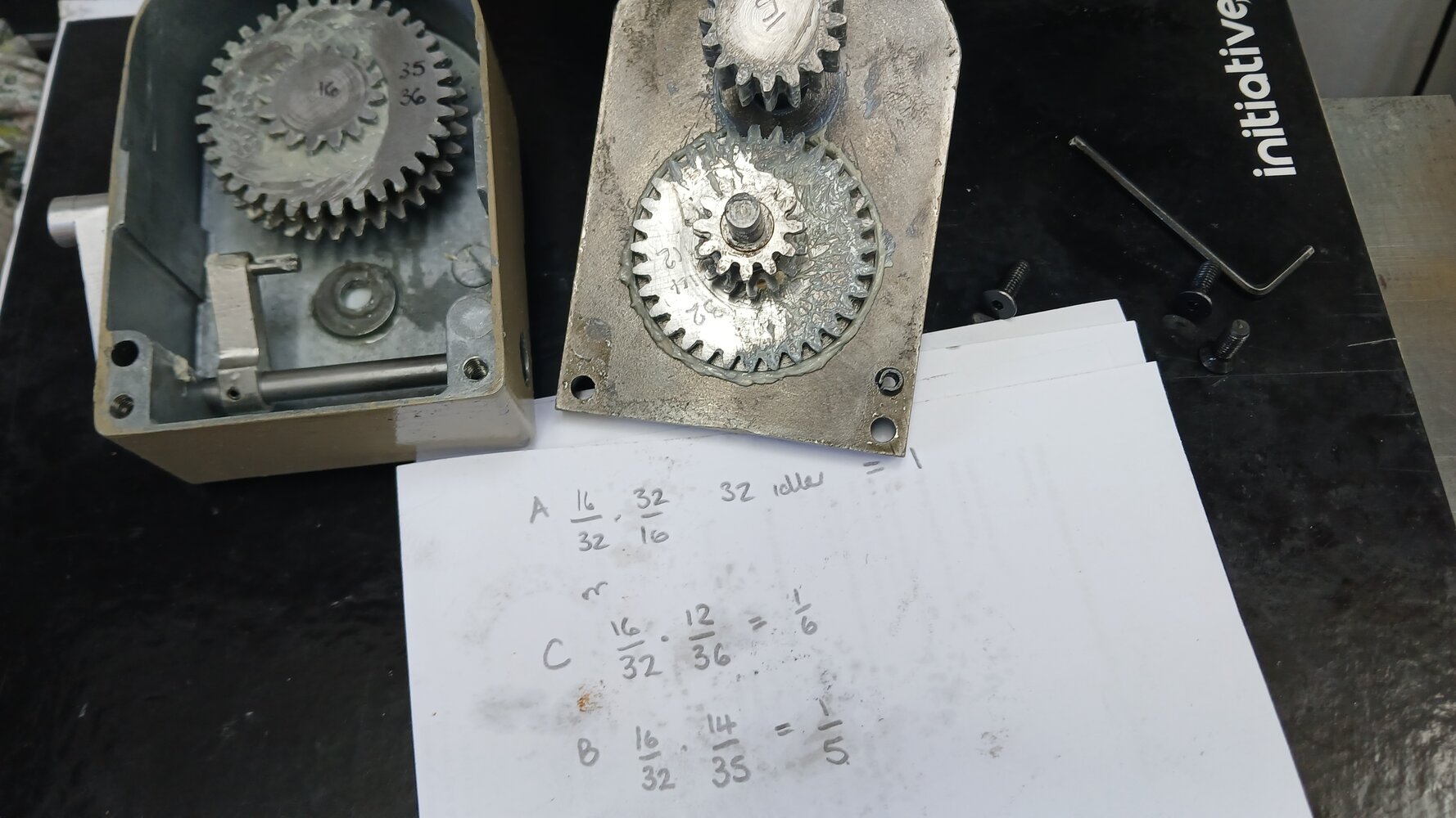

The pinion that engages with the leadscrew has Z teeth. The leadscrew has a pitch of P. So, per revolution of the dial, the "lead" or travel of the leadscrew is Z.P, so 16 x 0.25" = 4 inches for the standard 16T pinion. 4 inches is an integer number of any whole number of TPI thread, eg 13, 16, 20TPI and also a whole number of half or quarter TPI threads, such as 5 1/2TPI or 2 1/4TPI, both of which the M300 can do.
Half a turn works for whole TPI and half TPI threads and a quarter works for whole TPI threads.
But they're not metric! True, but if you put a 20T pinion on it, one turn of the pinion is 5 inches travel, or 127mm. So one number works for 0.5mm and 1mm pitch threads.

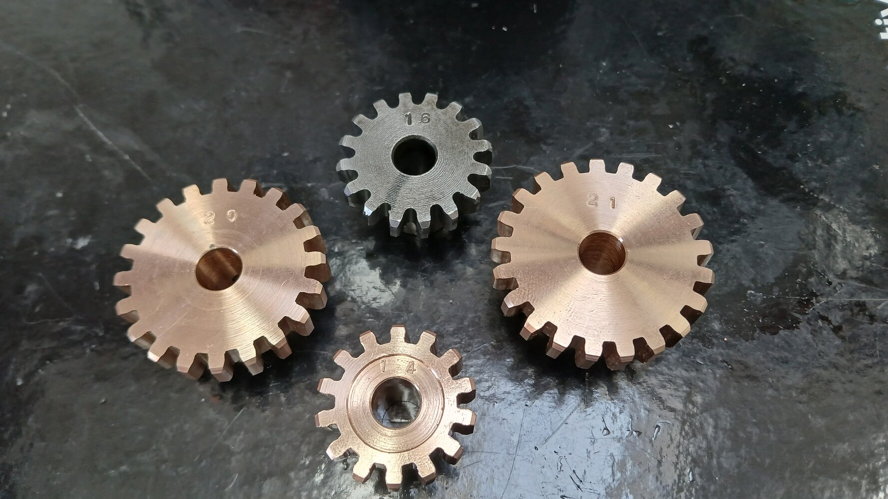

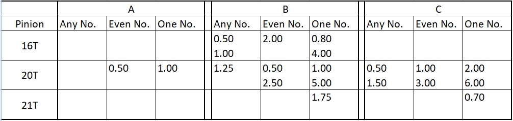

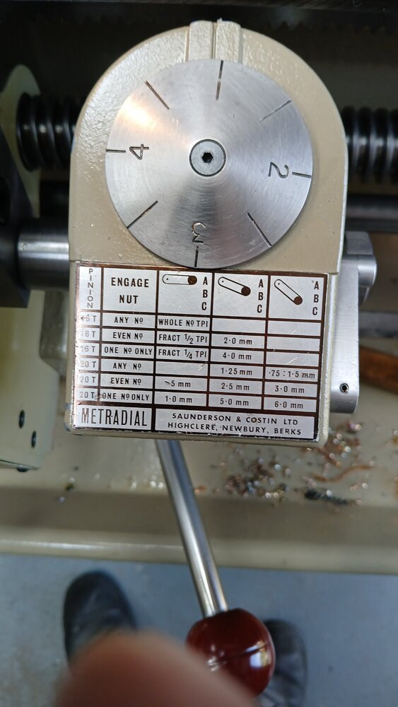

Still not very exciting, however the lever on the side of the dial has 3 positions. Position A is direct drive, albeit through a gear train, which gives us the answers above. Position B however switches in a gear reduction between the pinion and dial of 5:1 and position C a reduction of 6:1. Now the lead between one number coming around is 635 and 762mm respectively. This means the maths works for thread pitches of 0.5, 0.8, 1.0, 1.25, 1.50, 2.0, 3.0, 4.0, 5.0 and 6.0mm. Add the option of a 21T pinion and engaging on one number it works for 0.7 and 1.75mm pitches too:
Here's a table to summarise:

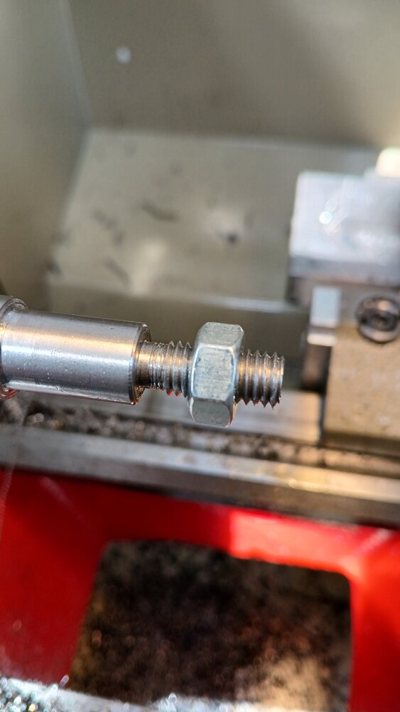

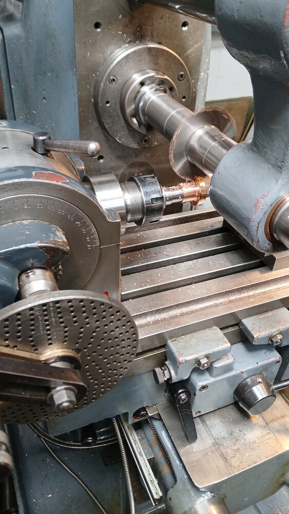

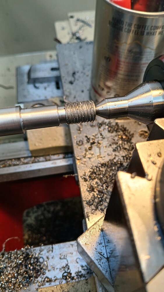

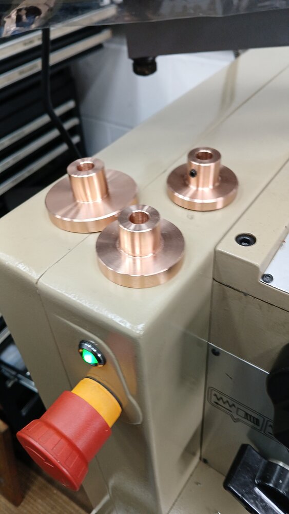

So I'm going to be making a couple of pinions and funnily enough, I'm not going to try and sell it now!
