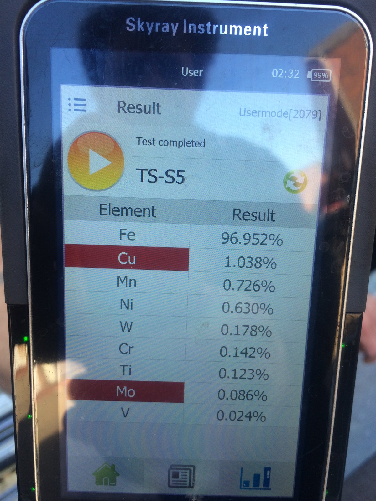

Is there any metallurgist on here who can name a equivalent before I go to default setting (en24)
Thanks
The copper is higher than Ive come across before.Its similar to Corten but 1% Cu is too high.....are the hubs plated?
Im thinking the hubs pre date steel classification back when individual producers made their own composition
