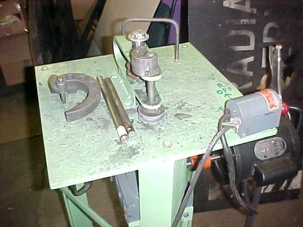

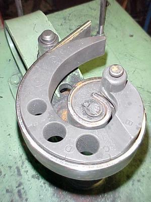

Hello all, what would i expect to pay for an average metal scroller, never worked with one before so what should i avoid and go for?
I scroll about 1,000 scrolls a day so i have used one. My choice http://www.shopoutfitters.com You can get cheaper ones and thats up to you. I also have a motorized one for that many scrolls...Bob
Scrolling and metal working hand tools.
You cant wrong with Metal Craft, I had their scroll maker, decent kit but did not fit in with my plans. I have used there roller/bender tools for years. Fantastic pieces of kit.
http://www.metal-craft.co.uk/index.php?route=information/information&information_id=11
Have a look at the users page then check out the tools section.
They do two ranges of scroll maker.
If you contact them let them you know you have come via this forum and ask if Barry can send you their DVD.
What to avoid? anything that seems to good to be true, it probably is. There are some dodgy looking knock offs of the metal craft range around.

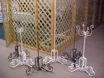

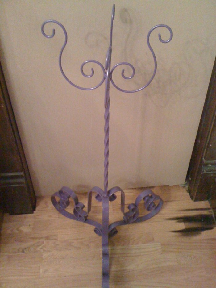

Chunko'.
Nice, are they plant stands?
A bit fancy for me but beautifully made, way better than average.

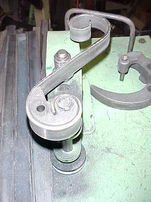

How did you curve the strip for the top sections?
Chunko'.
