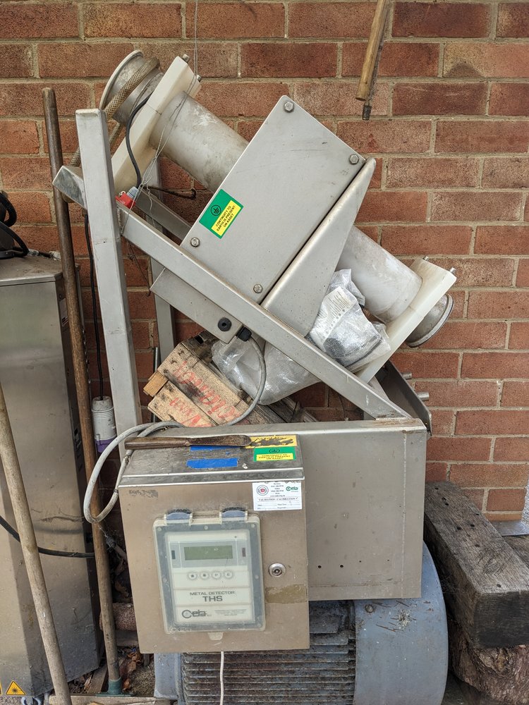

The idea I have is all wood is scanned before it enters the bench saw bench cabin, wooden table containing the detector made as a glued & pinned up construct , So a rectangular mouth of say 12 x 5 inches with at least two detector coils in/ around the rectangles a foot or so apart .Well no - you just shut the drive that pulls the wood in - unless its manual, in which case you have to have a siren, light, buzzer, whatever. I reckon you will need to make a pre table ahead of the main body - certainly do-able once you have the right shaped pickup coils
Spoke with Fizzy , his suggestion is a detector wand , but the Norbert's at the shed will either not bother using it or swipe it over the wood so quick missing nails/ staples or other ferrous metals etc. ..especially if they don't wear their glasses .
Doubt it without a lot of costly precision engineering.Can you change the planer blade carrier to have small blades like carbide machine tool inserts, a chipped blade then means turning or changing an insert so still machine downtime but if the inserts are cheaper and last for 4 metal strikes ?
One of the influencers at the shed didn't even want to spend £ 20 or so on a new drive belt for the motor &r a flat rubber one for the thicknesser drive
Good luck with that one
