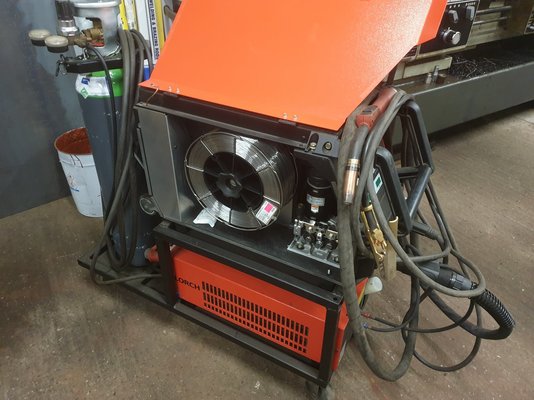

So I set it up in the S3, no changes from solid steel wire other than to take most of the tension off the rolls. I had to get a wire basket holder, as the 15kg reels come in centreless baskets.
I used the same gas I use for hard wire - 15% CO2, 2%O2, 83% Ar. This should effectively should act like a gas with up to 20% CO2 which is within the recommended 15-25% CO2
I got rid of the first 20-30 metres of the stuff just to eliminate dirty/corroded wire or damp flux.
I ran it in the synergic CV program for rutile fluxcore, and took the voltage trim down to -20, as it seemed quite spattery at 0. It ran really nicely at around 180-200 amps and 22 volts, which is slightly lower volts than the datasheet recommended.

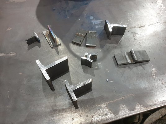

I ran a load of fillet test pieces off with 6mm and 8mm plate, pretty much all the same settings. No cleaning or any prep done - this was on purpose. I want it to burn through millscale and crap, if it works like this then it will DEFINITELY work on clean metal.
This 8mm was on the flat. - I ran it with a slight drag angle, near 90 degrees. I did another piece with a push angle like solid wire MIG and it looked and felt OK, but "If there's slag, we drag"
This was 6mm vertical up. I ran it with a 90 degree with slight push. I also did an 8mm vertical up, which looked way worse. I didn't chop this one up.
I cut some pieces out to check penetration and did a "scientific" bend test, of putting a sliced section in the vice and bending it with a big adjustable.

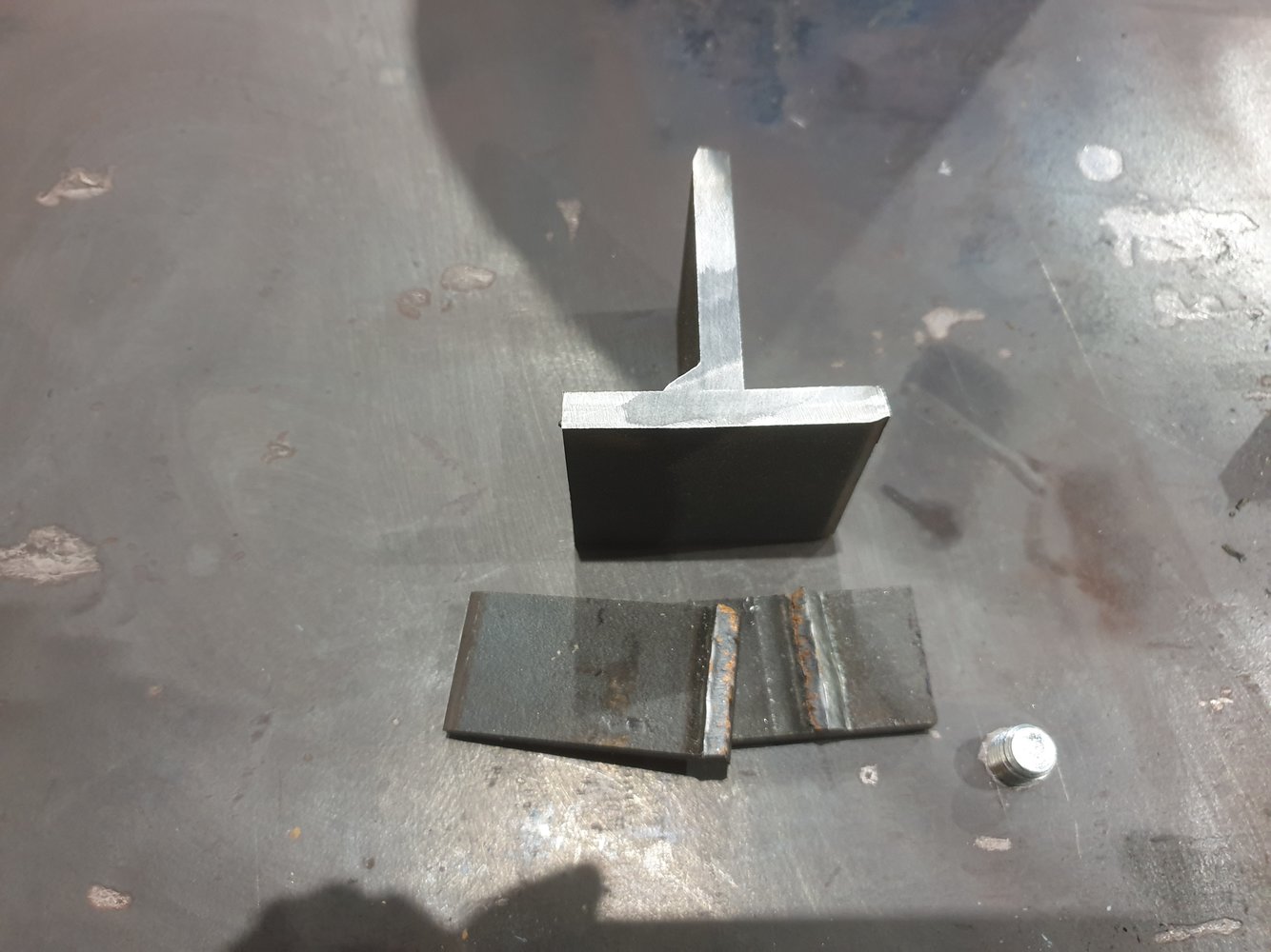

This was the uphill on 8mm. The profile is very poor, i should have paused a lot longer. Penetration was good (sorry my etching doesn't show up) but not especially deep. The millscale wouldn't have helped.
The weld broke, but it tore out of the parent material below the penetration. My theory is that the weld toes were really bad, and acted as stress risers, helping it to fail. I will have to repeat this test with either more amps, or pause on the toes for longer.

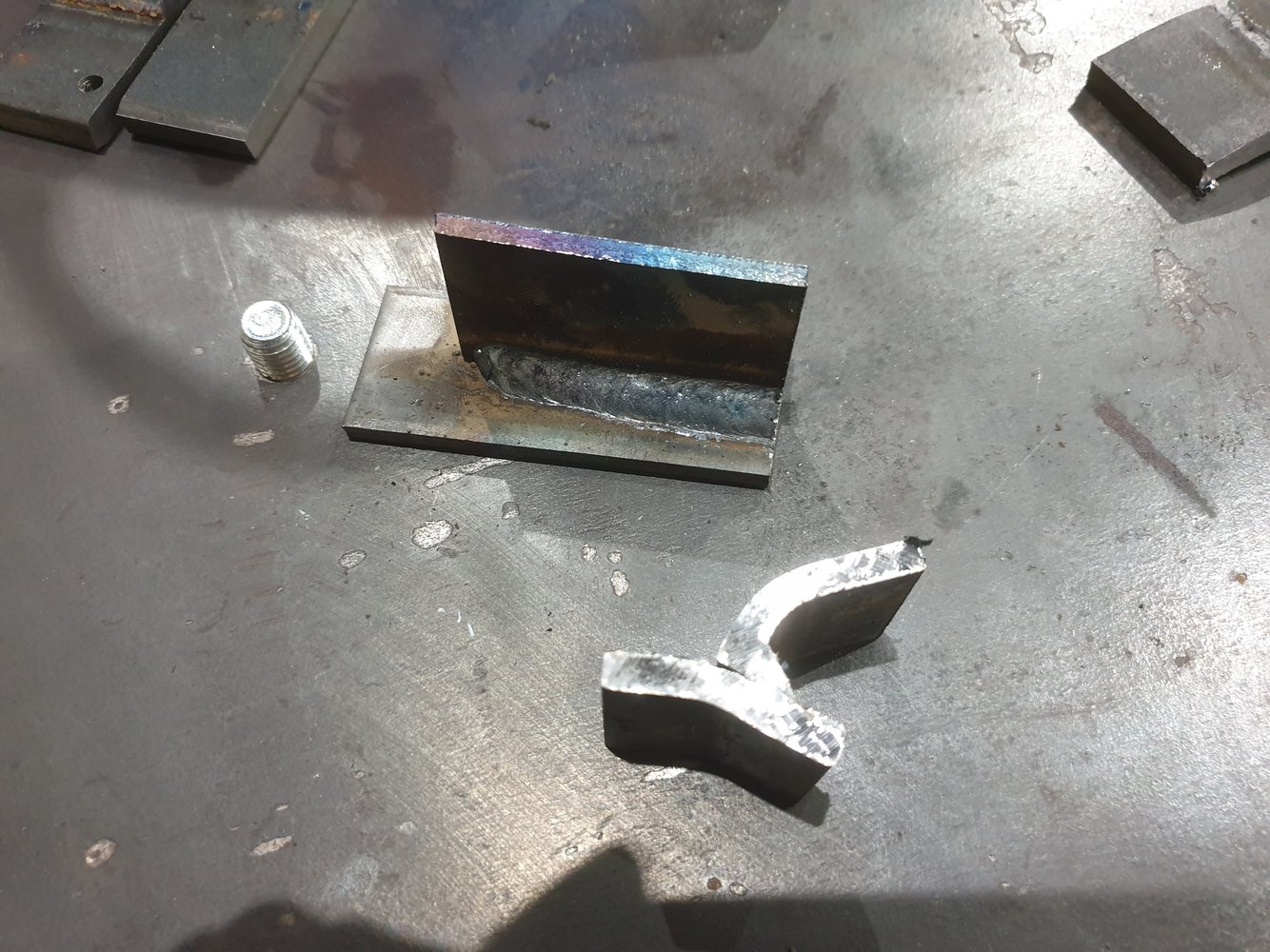

This was the flat on 8mm. This was entirely my fault. The weld was too cold and too small. Penetration was poor, barely nipping the root, and it snapped in the middle of the weld. I need to repeat this test with a load more amps.

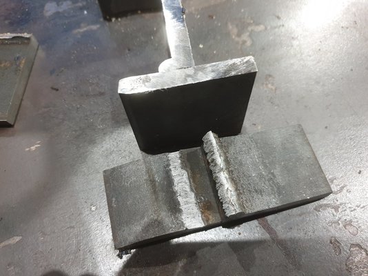

This was the flat on 6mm. Same amps as the 8mm. Profile is good, and the weld did not break at all. Plenty penetration.
