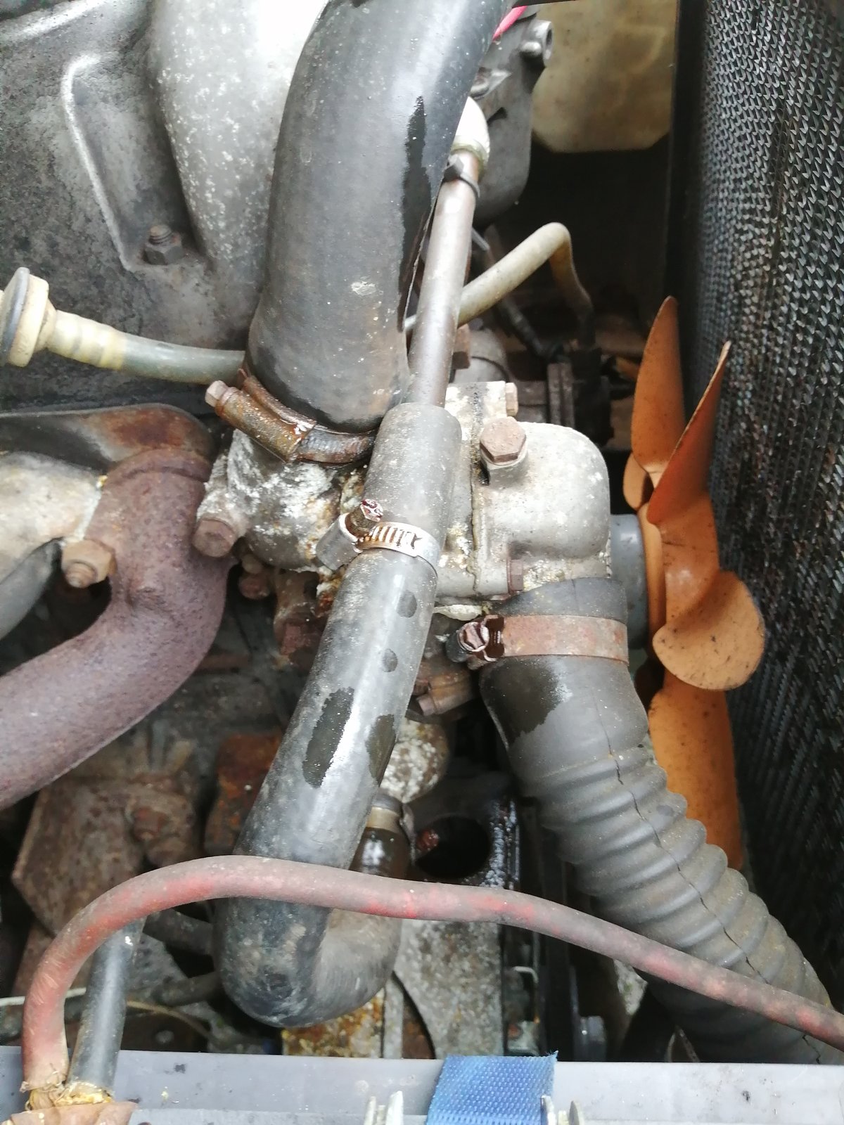

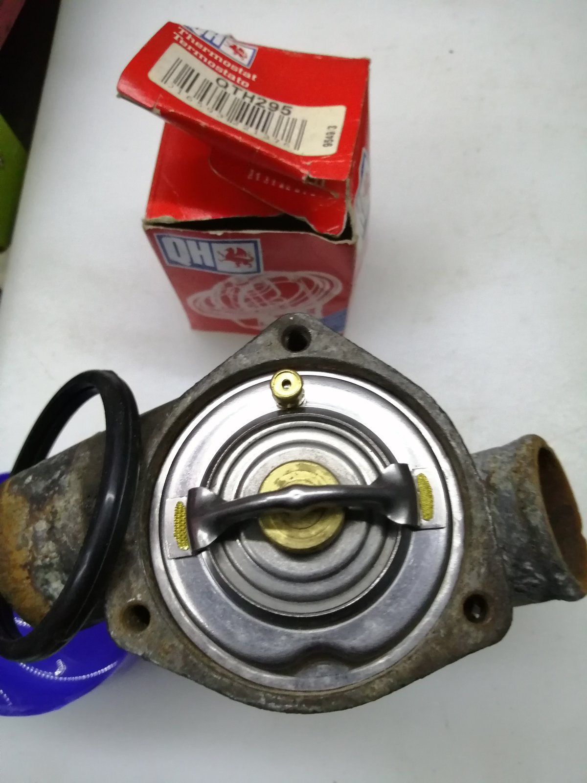

That’s good to know. I’m not normally one to google answers I don’t know but it looked a lot like my old sprinterYep. Gasket goes over the thermostat like on a few Renault clio engines...It leaks otherwise...smear a little grease on the gasket to help it seat in the housing...

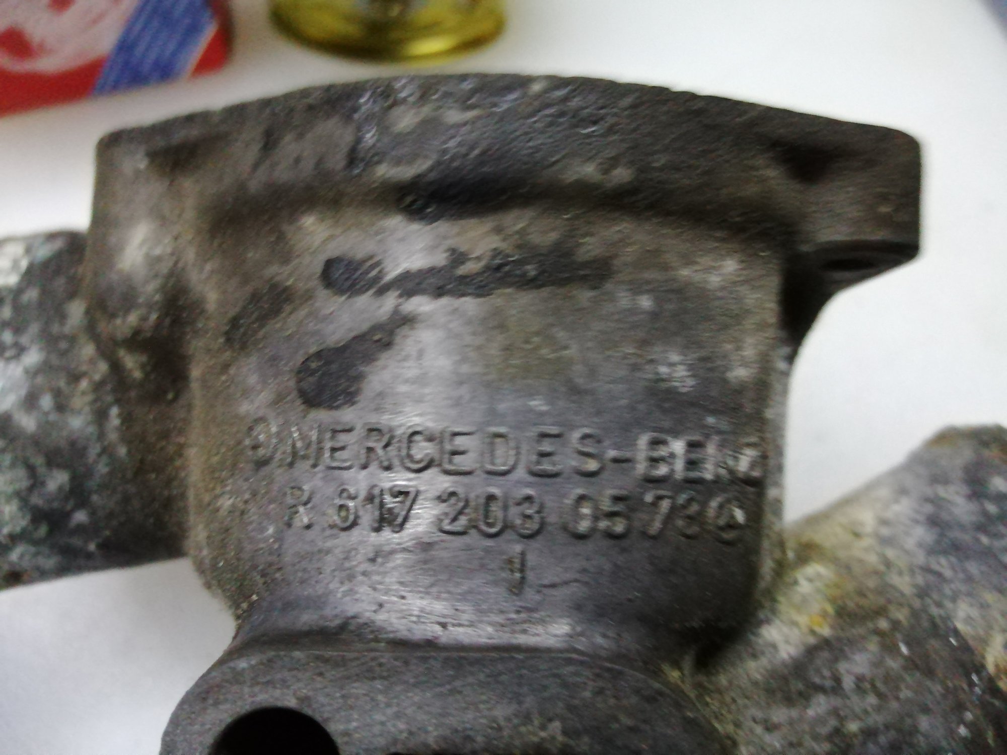

Thanks looks an odd way of doing it but that should seal it, double checked the part numbers and its the correct one?Any help?
Ball valve goes to the highest pointThanks looks an odd way of doing it but that should seal it, double checked the part numbers and its the correct one?
Now would the jiggle pin thing go in any particular place I thought at 12 O'Clock as its vertically mounted?
Thats what got me thinking but its mounted vertically.Thanks looks an odd way of doing it but that should seal it, double checked the part numbers and its the correct one?
