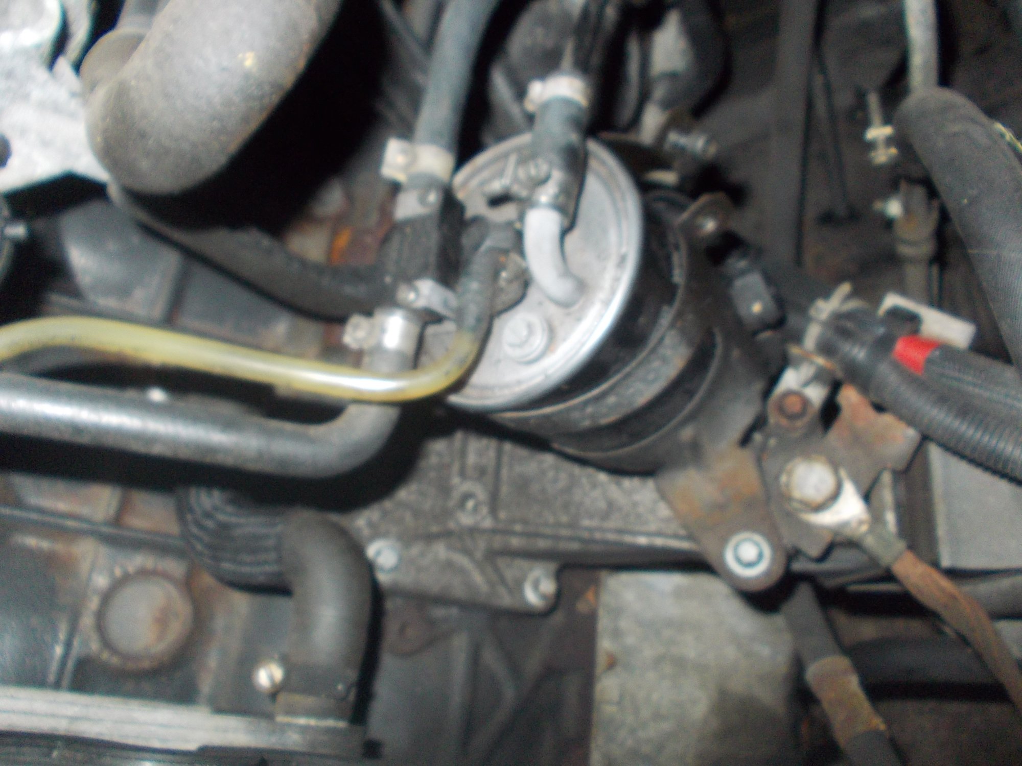

These suffer with air getting into the fuel system via the center pipe on the fuel filter and o ring on the left side pipes on the filter.
