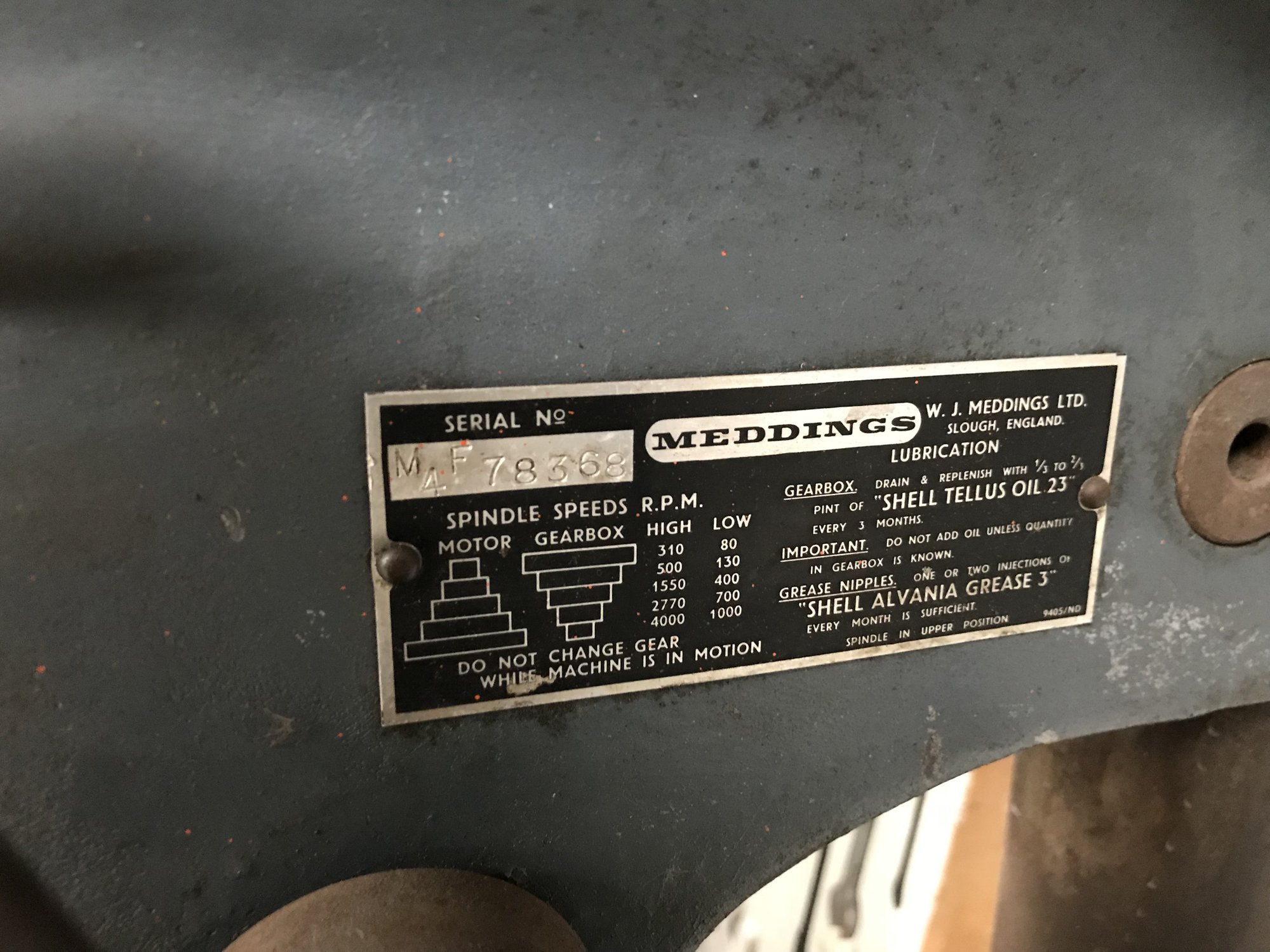

I have just swapped a 3 phase motor to a single phase on a Meddings pillar drill, It all runs nice no noises or mad wobbles, So before i start using it i decided to make sure it was greased in all the right points, Then i remembered it had been laid on its side to move and as it has a 2 speed gearbox it may have lost oil, I can see there is a fill point under the cover but how much and what kind of oil should i be using?
I am in the garage all day Friday so i will take a good look.
