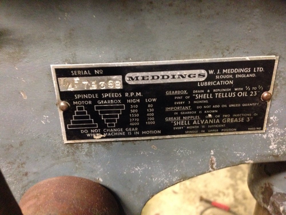

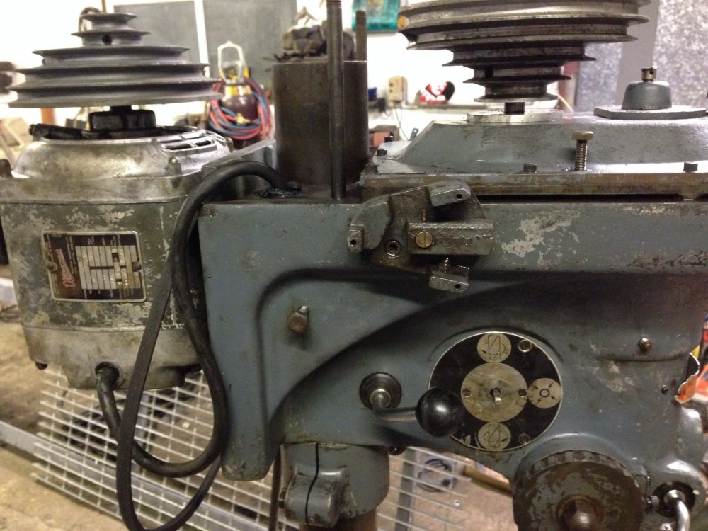

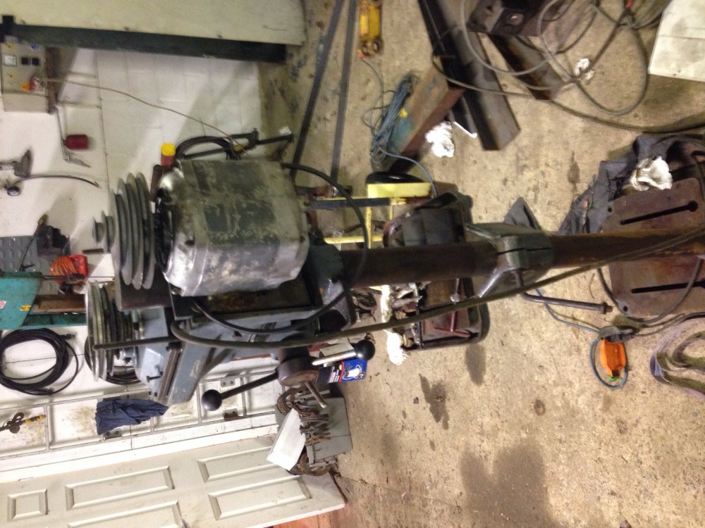

Anyone know much about these, particularly how they are wired up as ours keeps tripping the rcd and where we might source some gearbox oil and the correct grease. We have re-wired the reverse/forward switch on the side, as the wires had broken down and perished, but it's still tripping. There is a red white green and blue wire, but no plug was on the machine when we bought it. We may try wiring up the motor direct and that way we can rule out the switch being faulty.
Some pics for you, this will be up for sale once restored to its full glory.
