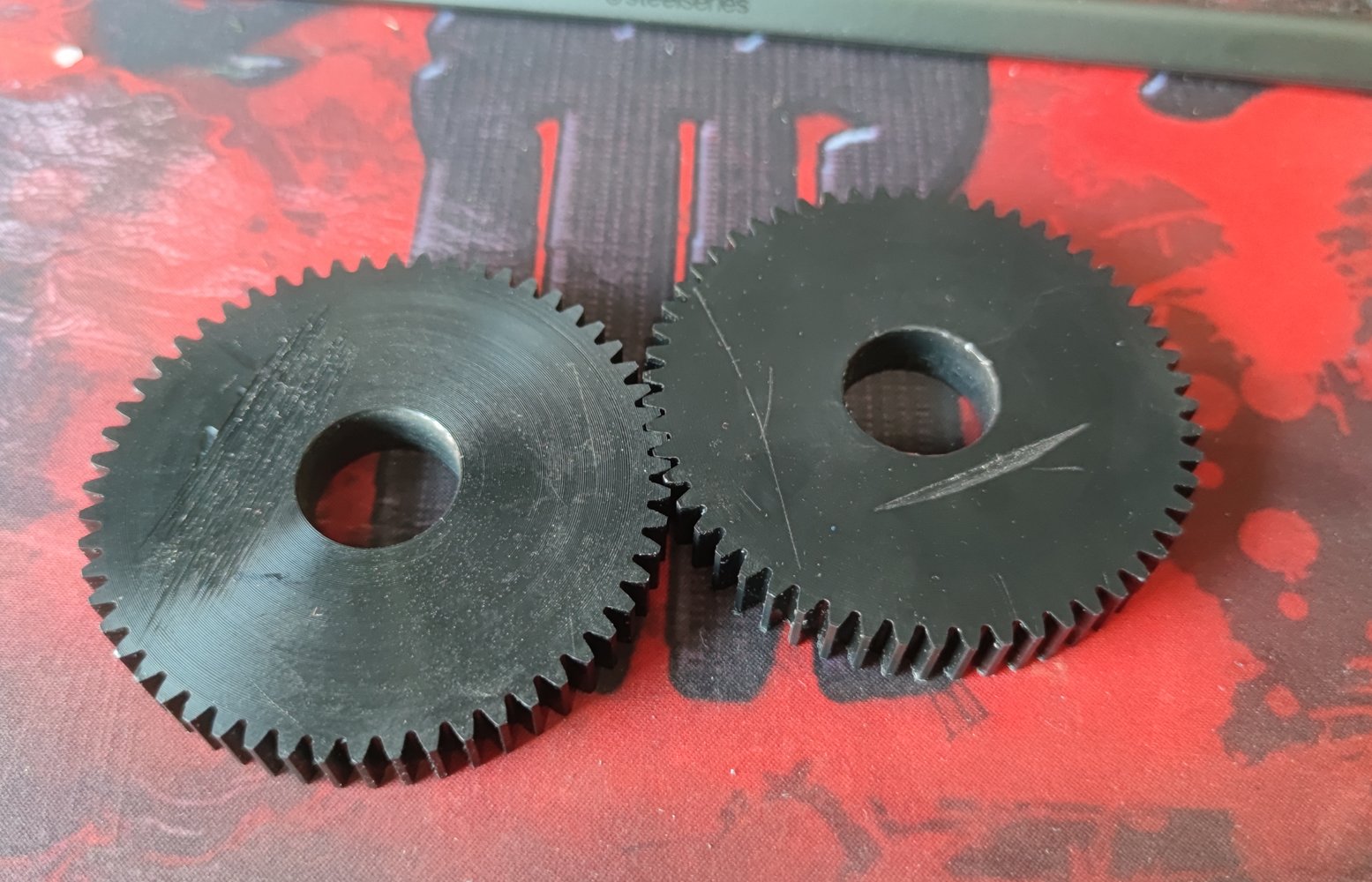

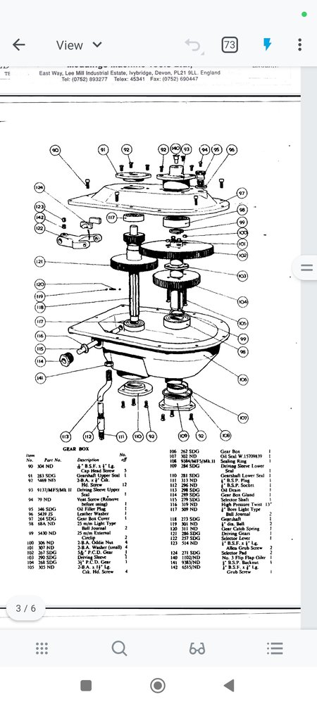

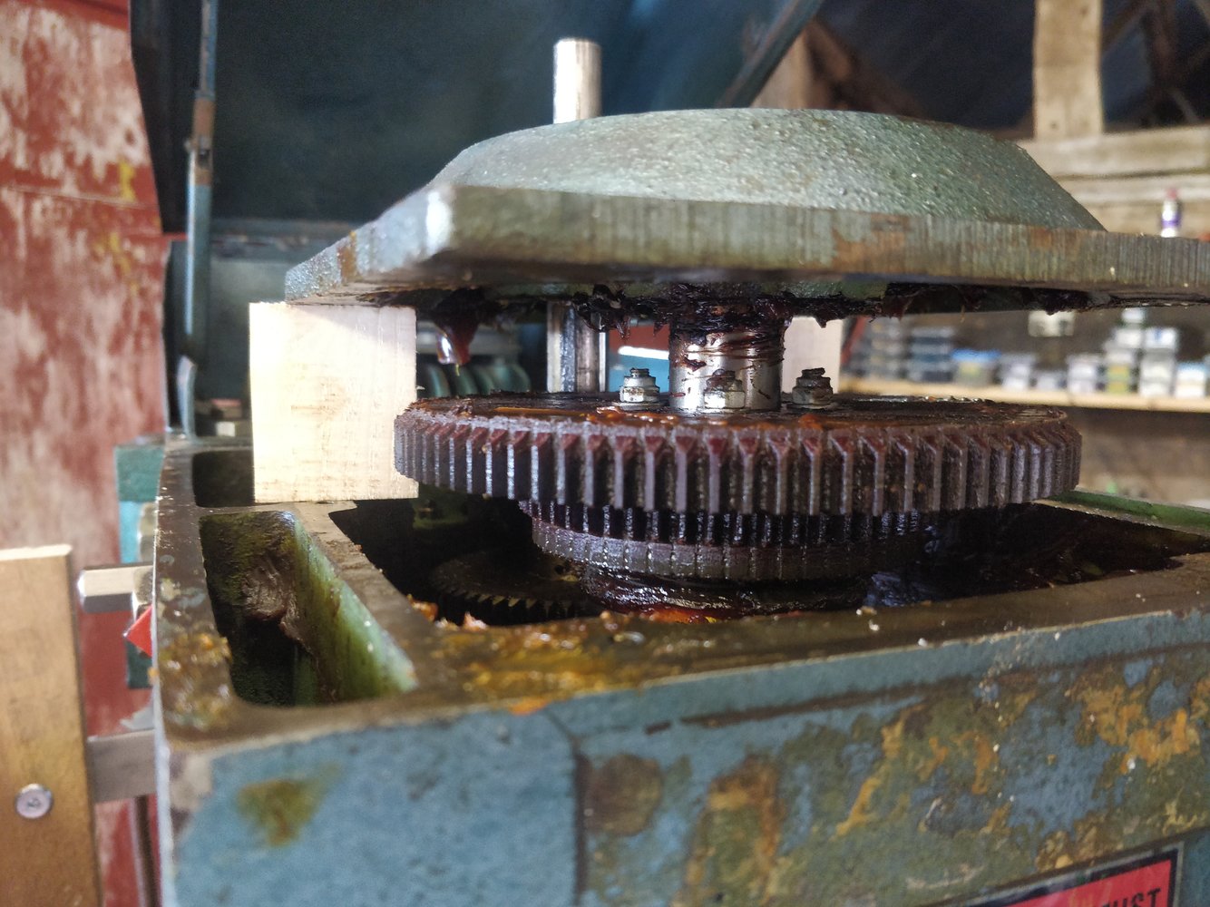

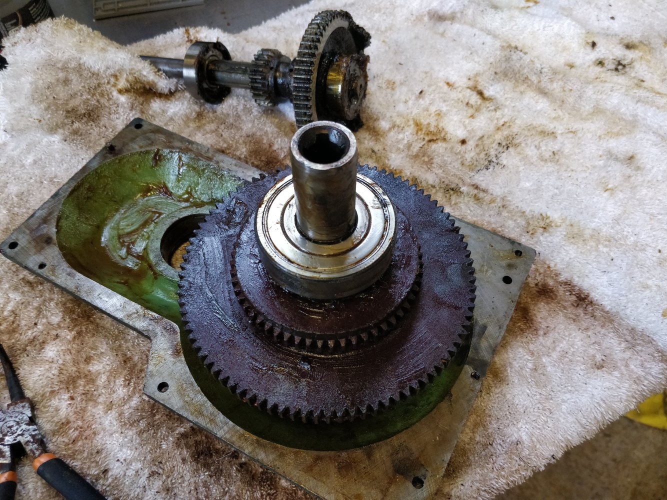

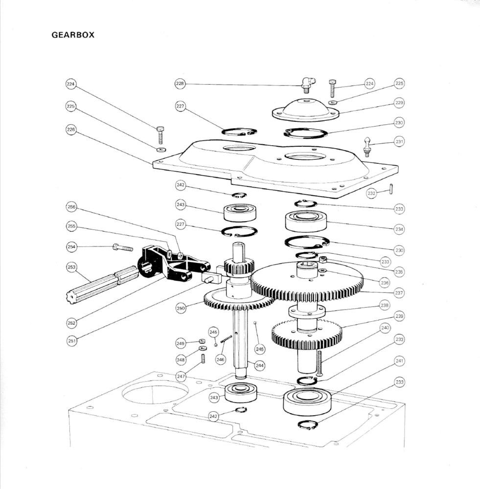

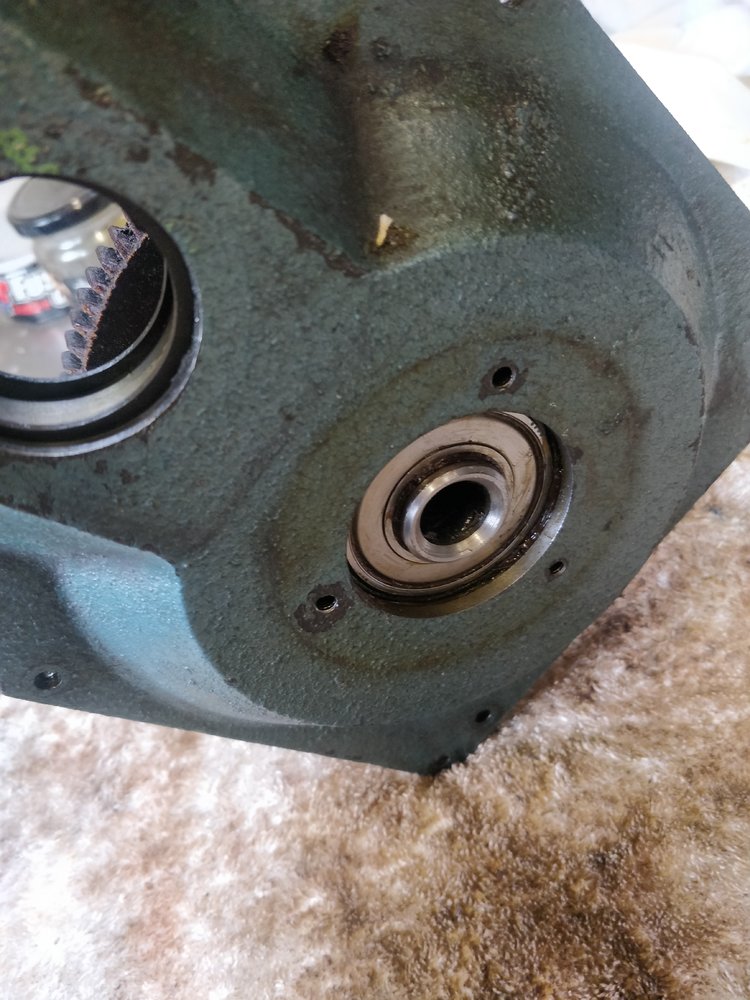

I wondered if anyone could give me some advice on removing the gearbox cover on a 1978 Meddings MF 4/3. I purchased it recently knowing there may be ‘issues’ which may or may not be within my skillset to resolve. While the motor works, there’s no play in the quill and the table isn't too bad, the main problem I’ve got with this machine is failure of the high range gear to engage. I would like to get inside the gearbox to disassemble and replace any defective parts prior to reassembly, hopefully.
Having removed the pulley, circlips retaining bearings and all the M5 bolts around the perimeter, the gearbox cover doesn’t budge and there’s no play. Can anyone suggest how it can be removed?
Any information would be gratefully received.
