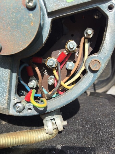

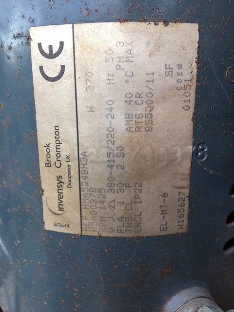

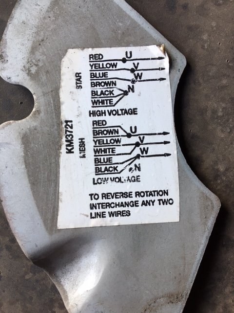

You could fit a single-phase, not a BAD idea but unless you can get a secondhand bargain it's likely to cost more than a cheap Chinese VFD...All wired up now thank you all @Agroshield, @Richiew .
The drive belt is a little too tight, so it struggles a little to start. It's also worn out, so I'll kill two birds, and get one that fits, and isn't putting everything under strain.
I now need to invest in another VFD (As specced by @Hopefuldave ), alternatively I'm tempted to just put on a single phase motor instead - is that such a bad idea?
