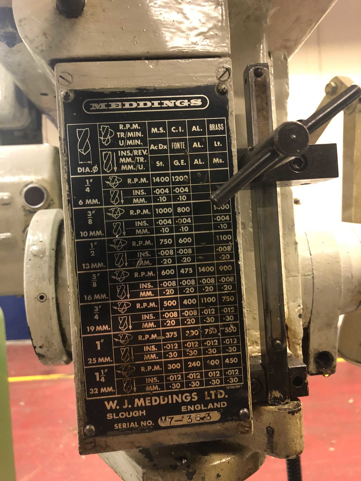

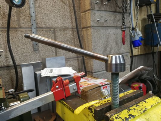

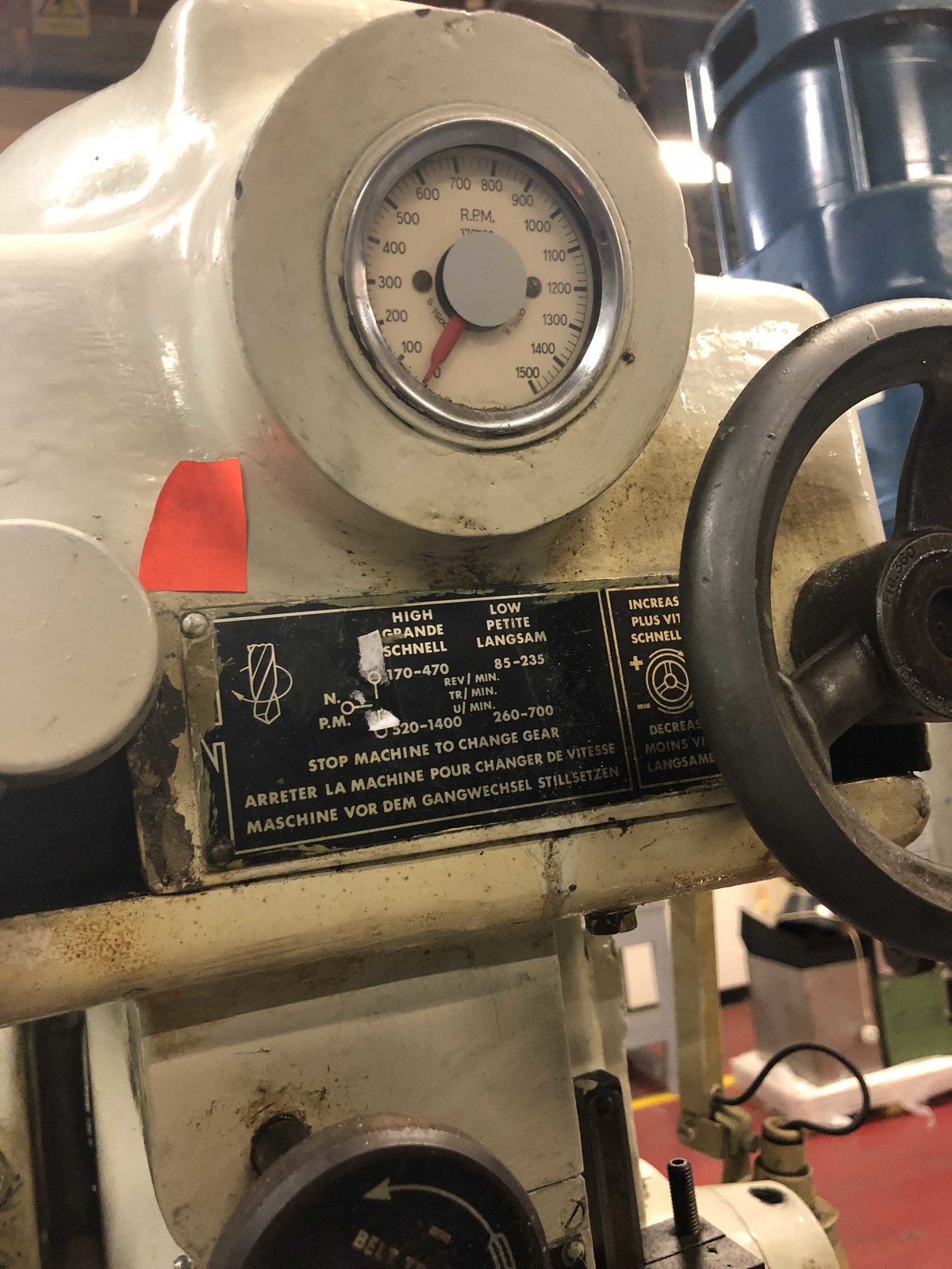

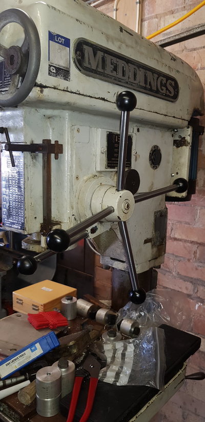

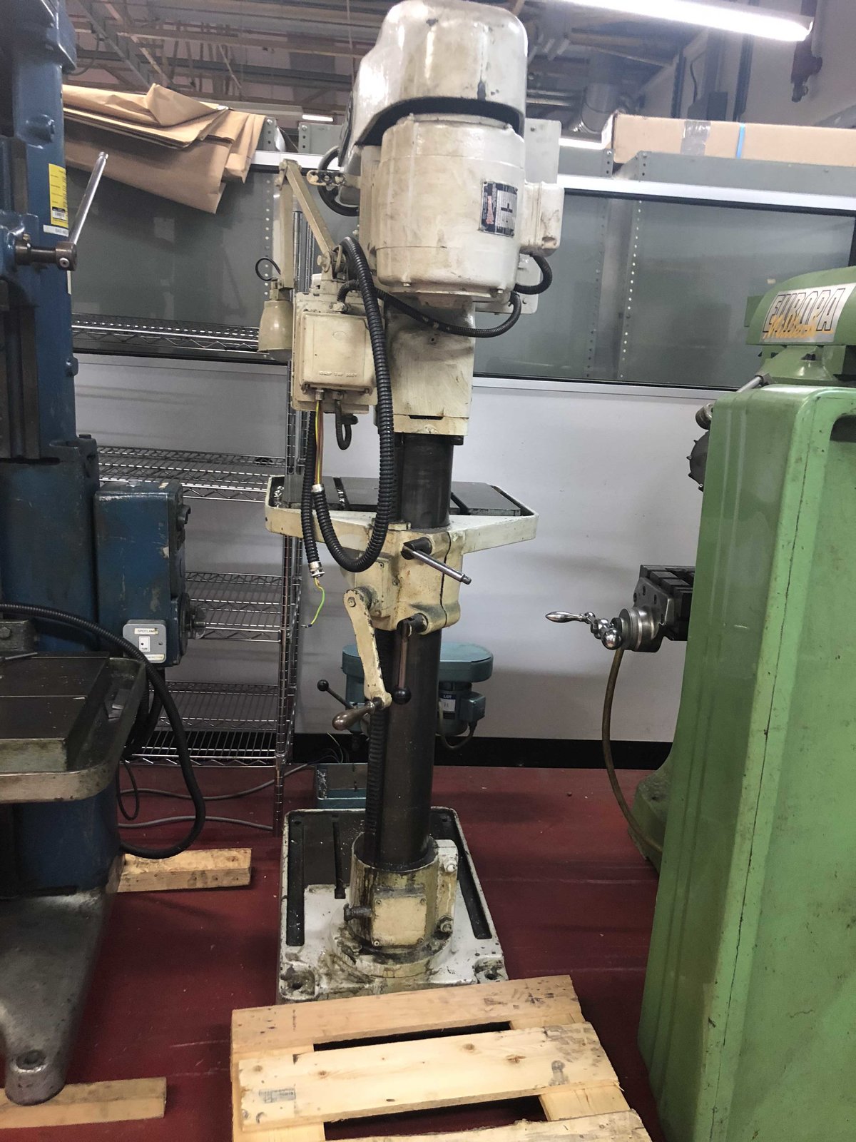

Just made and fitted new set of quill feed handles as the original ones were missing.
I've already fitted another 3ph motor and a vfd so I can vari the spindle speed
I might even give it a paraffin n paint overhaul.
what size morse taper is that, then?
