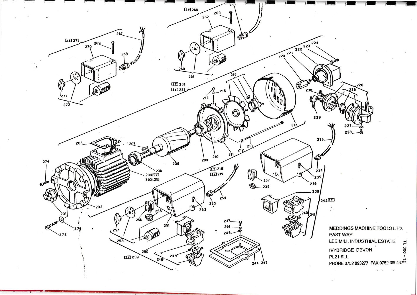

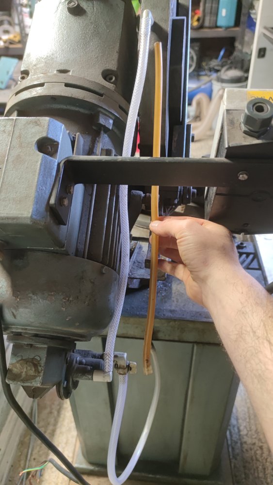

With the suds pump on the back of the motor, it might be quite difficult to find a replacement motor in 230v that will still drive it. If you do end up going the new motor route, you might have to change to an electric pump. I think the pumps are almost identical to a mechanical fuel pump.
