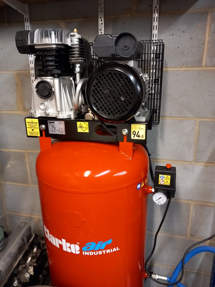

These are for the receiver mounted unit:
Ambient air temperature: 13° centigrade.
Humidity: Not measured.

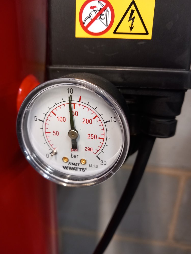

The receiver is 200 litres and it took a sliver over 11 minutes to fill it from empty to 150psi on the uncalibrated gauge. The first stage temperature at the end was 53°C, the second stage was 58°C and the receiver was 24°C.
I drained off the condensate the next day and about 5ml came out.
This may or may not be of interest to anyone, including me.
