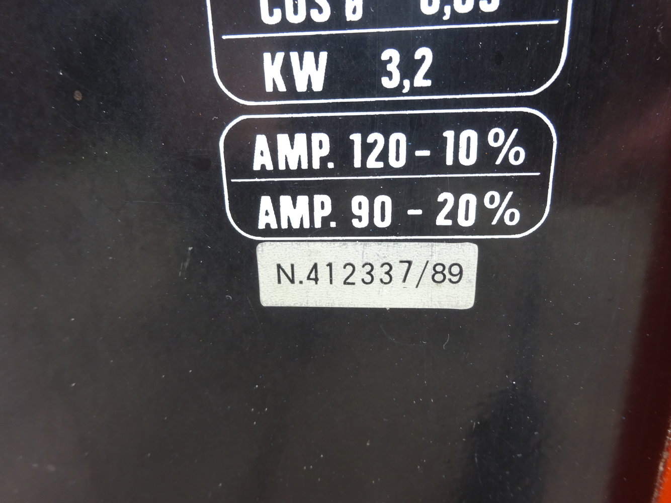

Hi, many thanks for the clear explanation. I now understand to rest to avoid distortion of sheet metal. I hardly use the maximum amps.No Monty, that would be the duty cycle 10% at 120 amps or 20% at 90 amps
Edit: 10% duty cycle means 1 minute welding 9 minutes resting when using 120 amps which is probably the maximum setting on that welder
