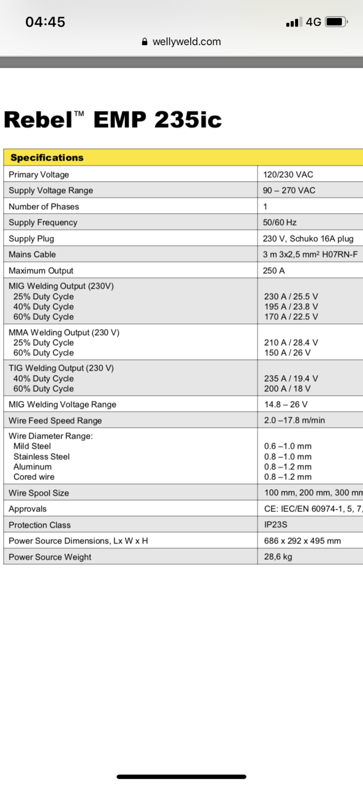

I just noticed that on some youtube videos some people have been able to get their rebel 235's to go to 29-30v on the mig settings for spray etc while here in the uk mines limited to 25.5-26v on 230v input. Why the huge difference? or am i missing something here because i feel limited to what kind of spray i can do with my 1.0mm wire
i should point out this is in Manuel mig not the smig function
