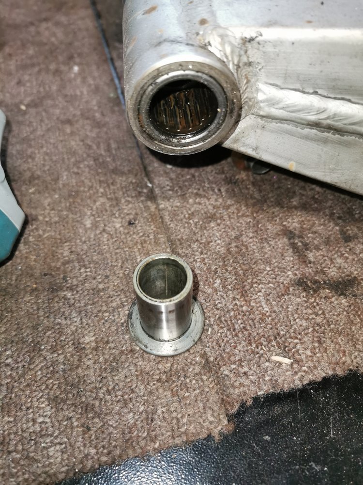

The sleeve would be inside the existing top hat and around the spindle, so in theory close to zero/very small amount of rotation. Given what you say it may make sense to make it an interference fit within the existing top hat and give it the same gap/tolerance between the sleeve and spindle as existing. Possibly over the top, but good practice nonetheless and not as if it'll cost a fortune.Limited movement is harder on the bearing than continuous - the same rollers roller back and forth on the same bit, possibly not even fully rotating themselves, the lube doesn't distributed, the rollers hammer themselves into the shaft (as mentioned up above rather more poshly already - the brinelling), rapid oscillation causes the rollers to "skid", wrong finish and hardness on the new parts sets the rollers up to fail early too.
Been some correct engineering advice on materials, treatment and finish above for long life . . . and other that gets it running and probably okay for an undermined time.
The needle roller sleeve is a good idea - still needs a good fit on the top hat/spindle to not set up early wear though.
If I was making it myself, I'd do the sleeve (either into the existing top hat, or the inner race). If it was a work job - do drawing and issue it, accept finished, checked component from supplier in a month or so.
