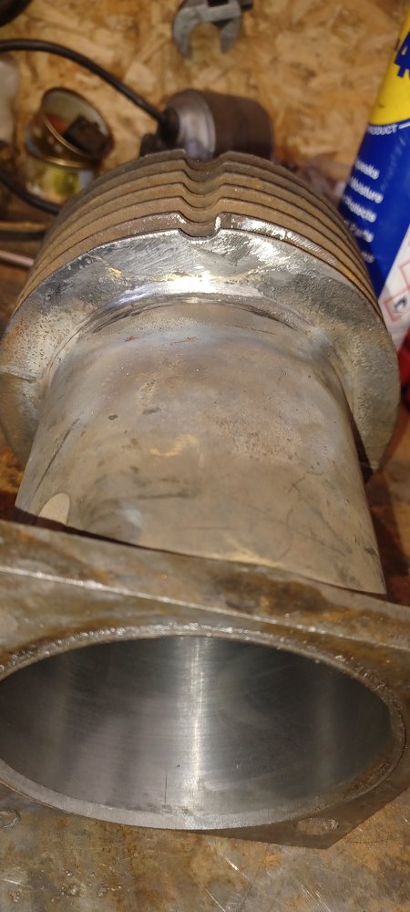

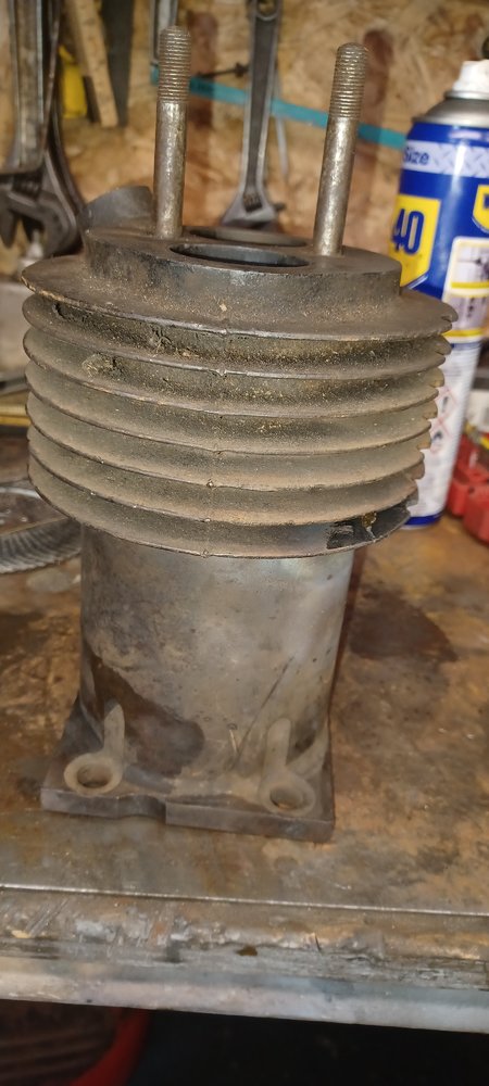

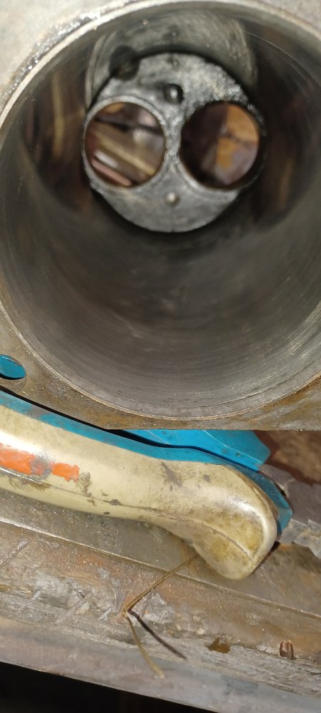

just done a cast iron silver solder fin repair on the fabled 90 bore ohv jap from around 1908 it was a pure out and out racer belt drive direct drive job

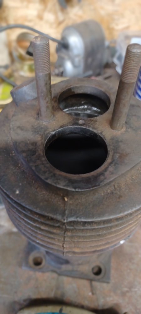

very clever arangement the valves are fitted from inside the bore and the head / ports /guide bits bolts on top
