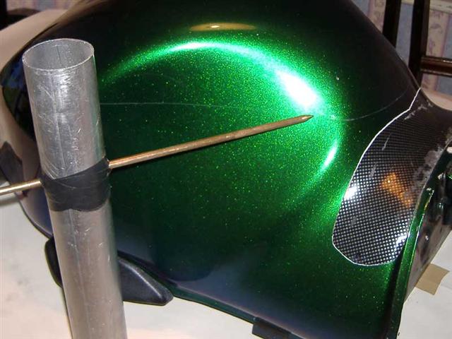

I'd use the same method as pete but with a scribe and stand.
