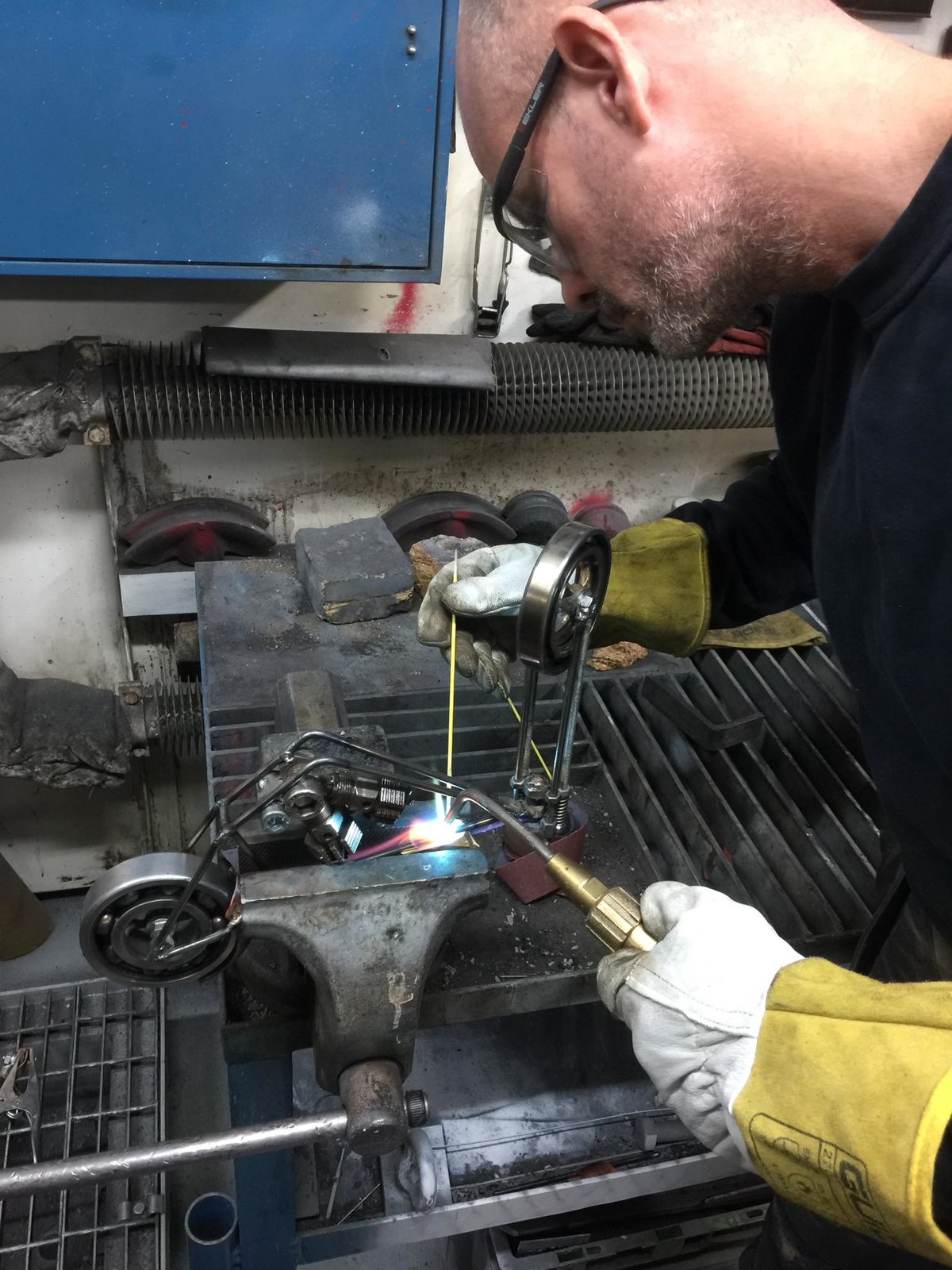

I’ve got MAPP gas, you’ll be hard pushed to braze with it even though the internet says you can. Trust me, I know from experience
It will be ok to free up bolts etc as it gets hot. With a wide flame you may find that it also heats other parts.
My go to solution is oxy propane but that’s a whole different ball game
A little roofers oxy turbo 90 set with the disposable bottles would be a decent option

the picture you have shown is not map gas on its own .that torch has oxygen as well and will braze very well . a gas torch on its own with map would have a bigger torch and flame and nowhere near the heatView attachment 159786
Evening folks.
The above pic is not mine.
Would it be possible to do this sort of thing with mapp gas?? Also would be any good for freeing stuck exhaust studs on bikes?
What sort of set up would I require? Seems there a few different options online.
