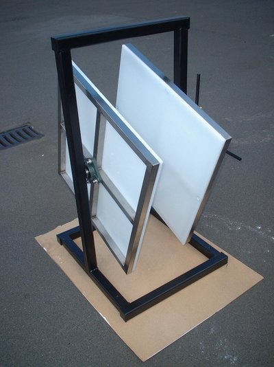

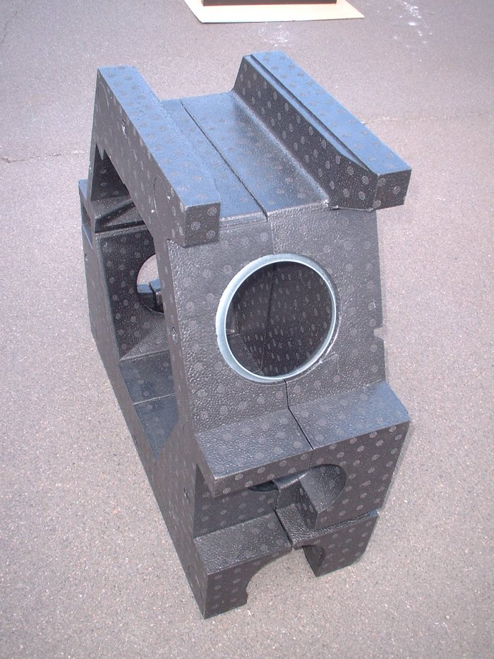

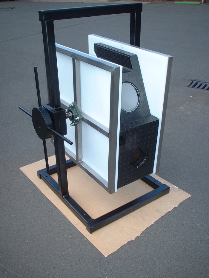

Another little gadget, a customer is making these polystyrene moulded air manifolds, apparently used in air conditioning systems, they are made in 2 halves and bonded together, my brief was to make a clamp to hold them together while the adhesive sets, and to allow them to be manipulated so that a bead of sealer can be neatly applied to the joint, its low volume production so no need to get carried away with over engineering, this was my solution, it works very well, it will have a few days trial in production then hopefully next week they'll order another one.
