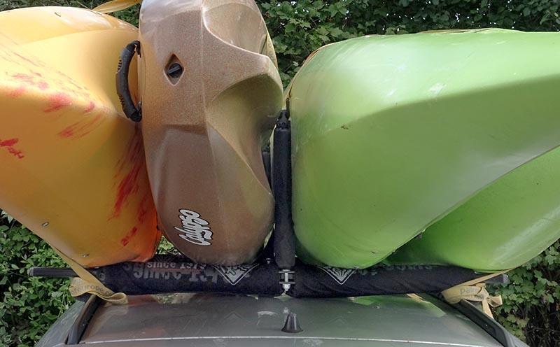

I bought a couple of used kayaks and after a sketchy drive home with them strapped to the car trailer I would like to weld up some J hooks.

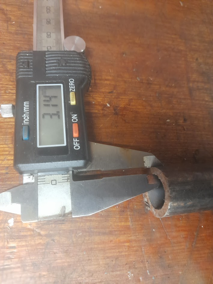

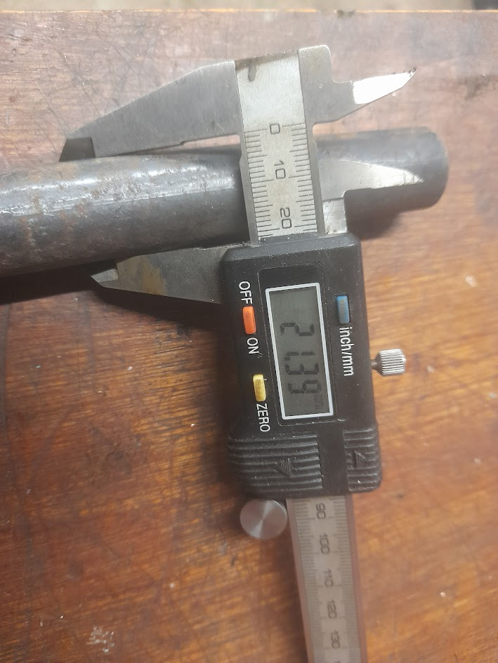

I happen to have a few lengths of mild steel tube that could do with getting used up, but how will I get decent looking bends without crushing the tube? I have a propane torch and no. 5 fly press. No hydraulic tube bender. We have a stand-type bender (for conduit?) at work.
