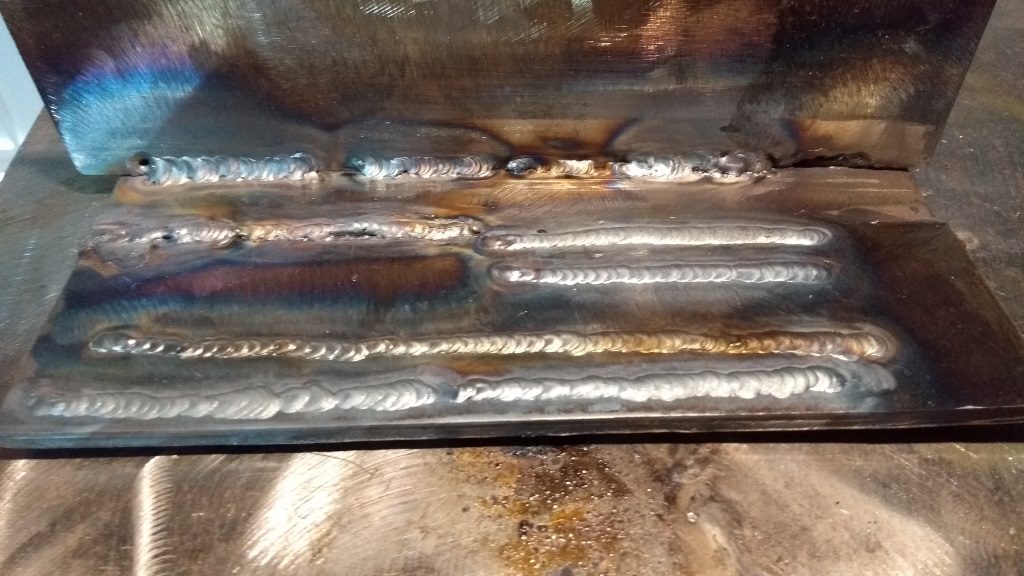

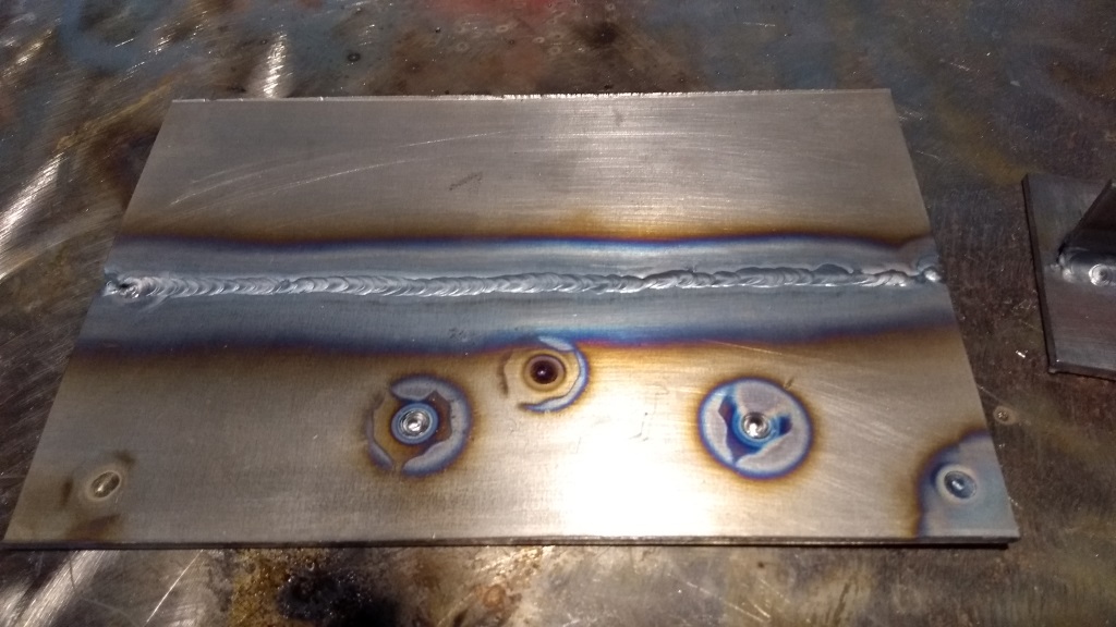

I've had about 3 hours of torch time in total on 3 different welding machines (Selco Genesis 200, Lincoln Squarewave 355 & Jasic DC TIG 180).
The latest is my little Jasic DC TIG which is my favourite machine so far. Initially I was struggling with fillets, but now I think I've finally figured it out. All joints below using 1.6mm lanth tungsten, 8lpm argon on the Jasic.
Any comments welcome.
Thanks
Fergal
2mm mild steel butt joint 80A
3mm mild steel fillet 100A and some beads
