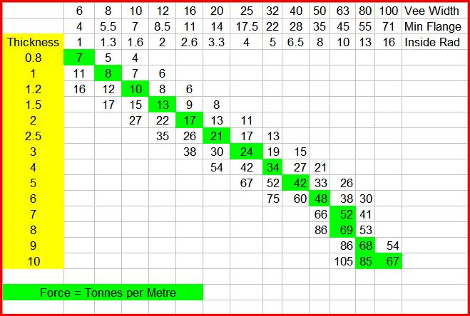

saw this and decided it looks good
but i want to make it into a finger press... simple idea
and bigger..... so i can bend maybe 1000mm of 1.5 mm 5 bar ally
cut the pressing die, and create a top rack that i can bolt tight to hold the fingers?
im my head its all simple
going to see if i can get a proper model on solidworks but am still learning
ideas and active criticism welcome
